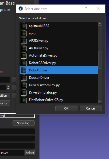

I recently started using RoboDK trying to control dobot Magician using online programming. First of all what I did was exactly follow the documentation and created a simple program to move the robot to a point and then back to the home position defined by targets.Everything looked great in the simulation and I successfully connected my robot with it. the status bar showed ready. In more options I selected DobotDriver but when I set the simulation to "Run on Robot" and double click my program it does not make the robot move along with it in the simulation the response is really fast. I am using RoboDK version 5.8 on windows.

What driver are you using?
Can you send us a print screen of the connection log?
I have attached a complete video and in it the connection log and the log window are also shown. I am using DobotDriver for Dobot Magician.

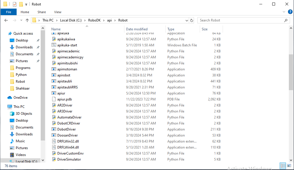

When I downloaded and installed RoboDK there is no driver named Dobot.py in the RoboDK/api/Robot/ the driver that was available was DobotDriver.exe. I have attached the screen shots of the list of drivers available at my end and folder that contains the Drivers

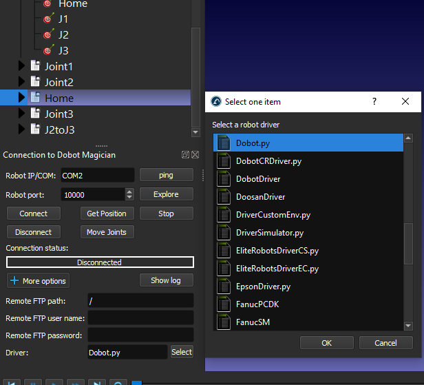

I also tried downloading this Dobot.py from the following link and placing it in the api/Robot folder but now the connection status bar does not even connect.

You can take the Dobot driver attached and place it here:
C:/RoboDK/api/robot/

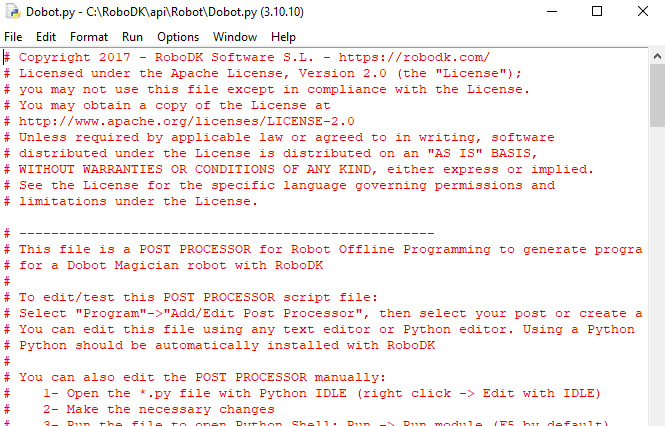

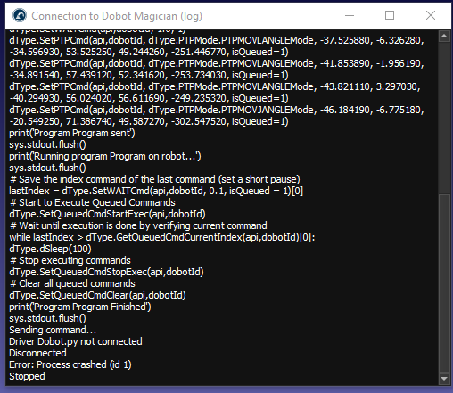

I downloaded the file you gave me and placed it in the corresponding folder but I think this file is the Post Processor which is used for offline programming and not the driver file I have attached the errors I am getting

Plus it still does not connect and the status bar does not go green saying "ready". The comments in the code told me that this file is the for the Post Processors. I am having issues with the Online Programming.
