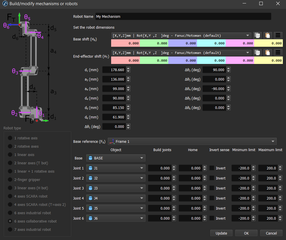

I have MyCobot Pi 320 model. I inserted the parameters stipulated by the company but J2, J3, J4, and J6 don't work.

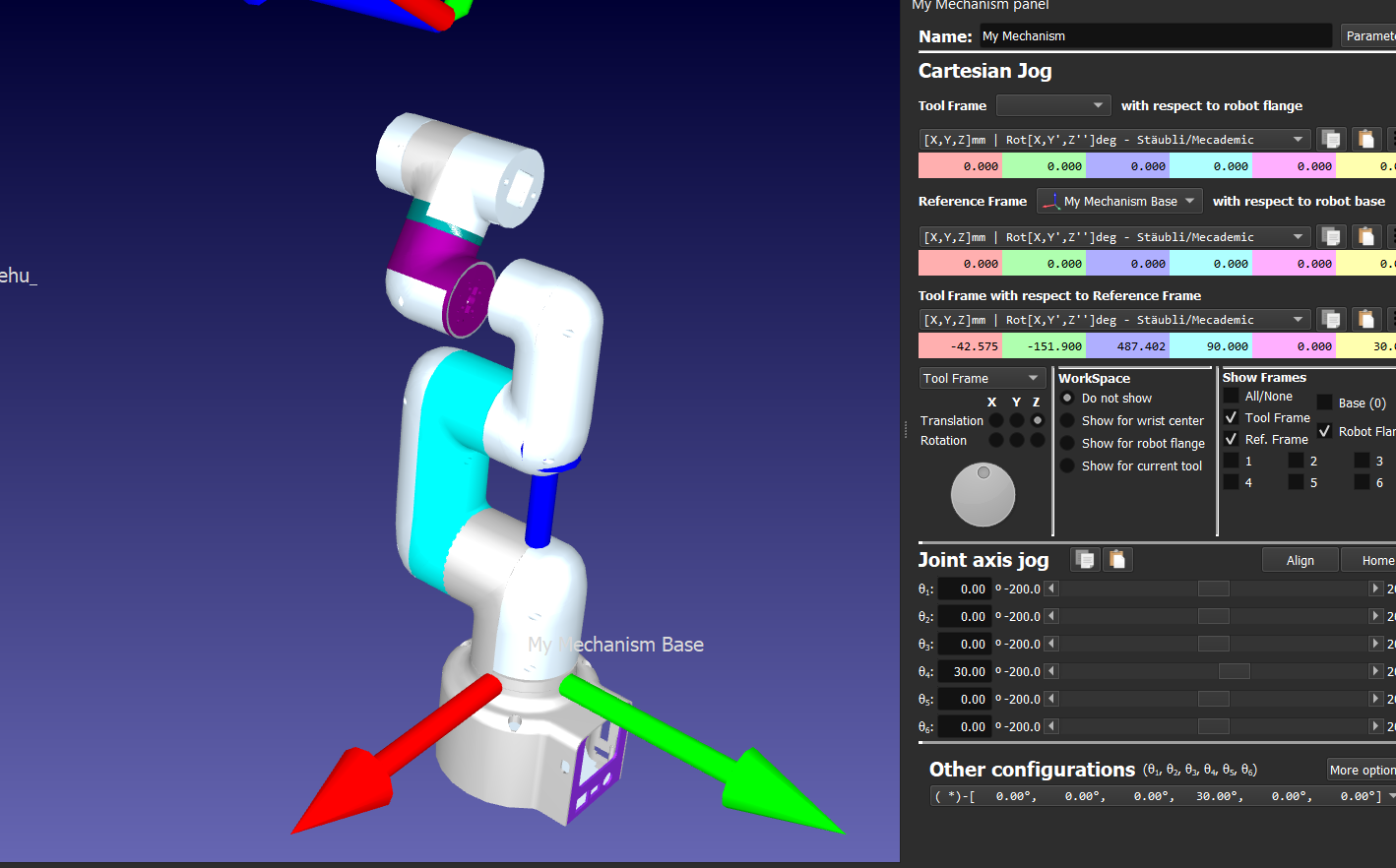

I attached my model, parameters, and an example of how it goes offset when I try to move any of the joints mentioned above.
What am I doing wrong?

The virtual base of the robot was too high in the model.
.robot   myCobot-320-Pi.robot (Size: 993.85 KB / Downloads: 829)
Thank you so much! I appreciate your help. Can you tell me what did you exactly do so I can apply it in the future to any other robot?
I think he simply moved the base so that it matches the physical base of the robot.
In other words, lower "Frame 1".
