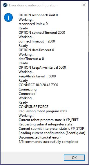

Yes, I have seen the post before: I have tried with version 1.8.1.0 with the same result on all points. I have attached error message from KUKA Configuration script.
