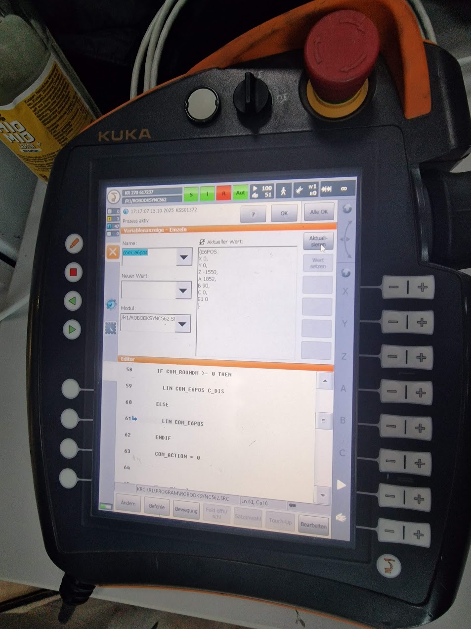

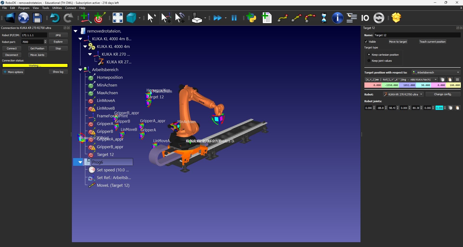

I’ve got screenshots showing:
- The RoboDK target (e.g. Target_12)
- The generated .dat file
- The actual robot setup
- The pendant showing the received E6POS values

In RoboDK, the target (Target 12) is defined as the following Cartesian pose:
X = 0
Y = -1550
Z = 1852
A = 90
B = 0
C = 180
When we generate the program offline (src/dat export), the dat file contains these exact values. Running the program directly on the controller works correctly, so the pose and base definitions are valid.
The issue only appears when running online through C3 Bridge. When using "Run on Robot", the values received by the robot on the smartPAD are:
X = 0
Y = 0
Z = -1550
A = 1852
B = 90
C = 0
This is not an offset or wrong base. The values are being placed into different fields. For example, Z becomes A, A becomes B, etc. Even if the base frame were incorrect, XYZ would still remain XYZ and ABC would remain ABC. The numerical values should not move from translation fields into rotation fields.
Joint targets work correctly when sent through C3 Bridge. Offline execution of the same Cartesian pose also works correctly. Only online streaming of Cartesian poses through the C3 Bridge driver produces incorrect mapping.
