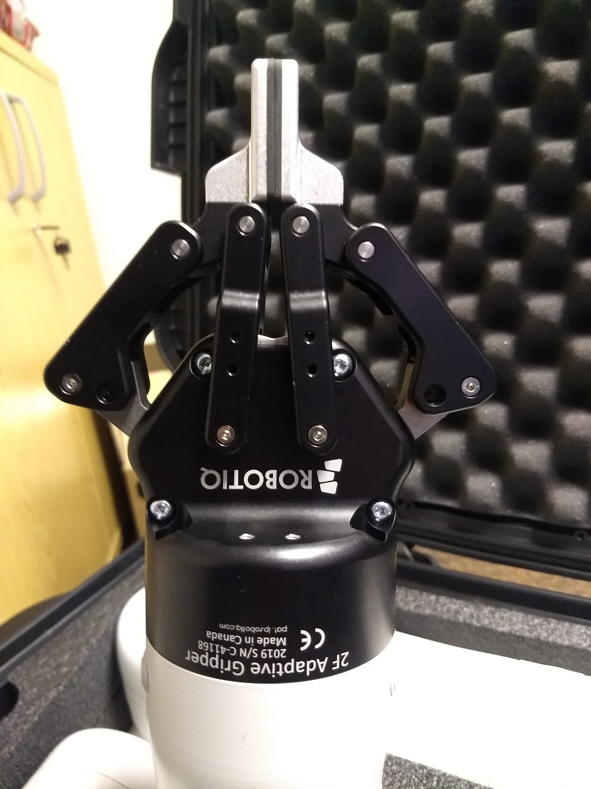

The programs in the DropBox link are the ones found in the robot's memory by default, I send you a photo of the gripper,
If you need anything else tell me
