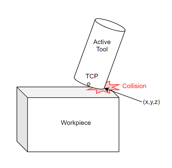

I would like to know if it is possible to fetch the point of collision between Active Tool and Worpiece in RoboDK through Py-API or otherwise?
Thank you!

01-24-2023, 06:24 PM
Unfortunately this is not possible at this moment.
01-25-2023, 03:53 PM
Okay! Thanks for the response Albert.
01-25-2023, 05:45 PM
If it can help someone else, the only collision call currently available that provides coordinates is Collision_Line.
More information here: https://robodk.com/doc/en/PythonAPI/robo...ision_Line
