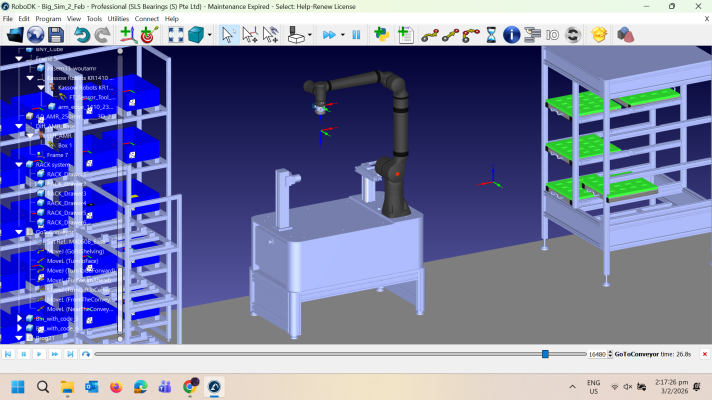

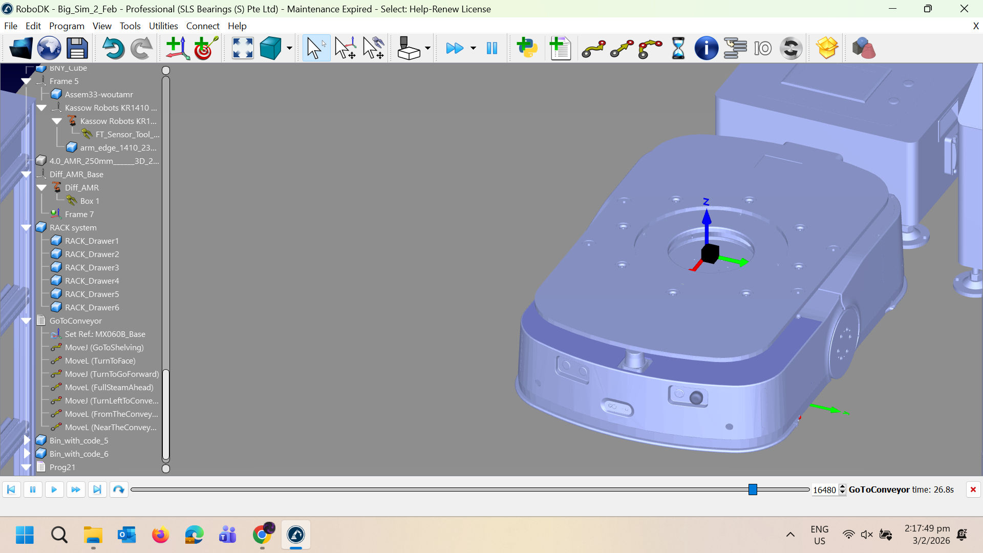

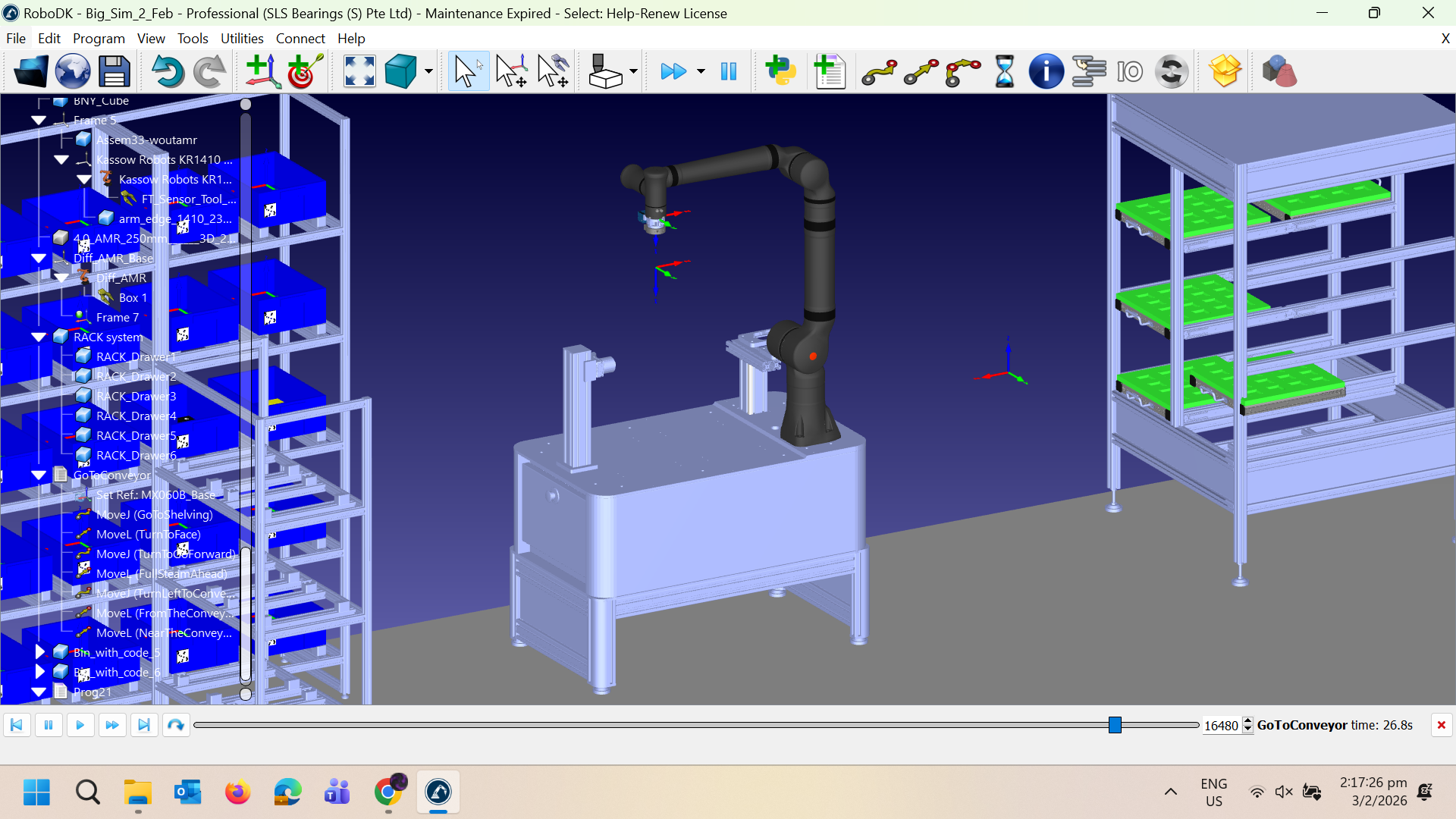

Hello RoboDK Team,
How could I use the AMR to lift a rack(RoboDK Object) that has a Robot(Model) inside a frame?
.mp4   What_I_want_to_do_in_RoboDK.mp4 (Size: 16.23 MB / Downloads: 272)
You can place the robot coordinate system with the robot tools and other objects inside an object within the tree. You can then attach this object to the AMR so everything moves with this mobile robot.
