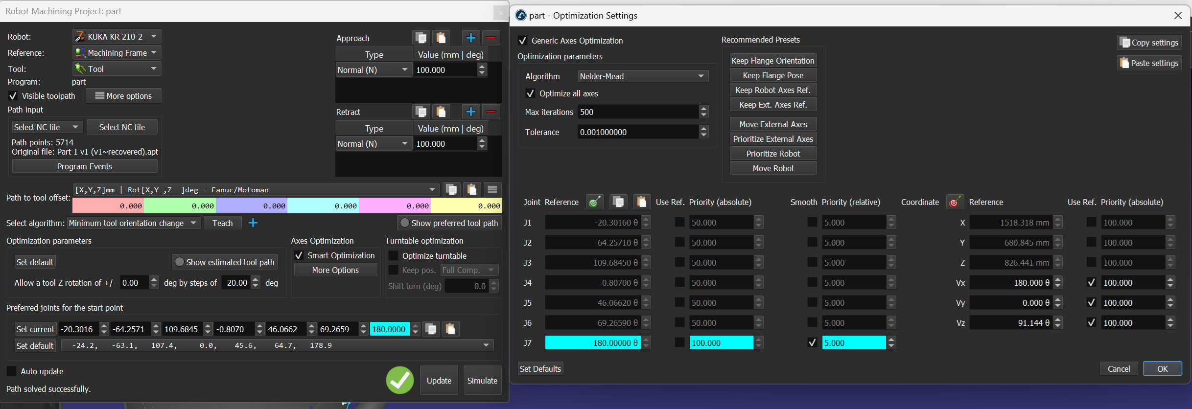

It is necessary to attach the machining frame to the flange of the rotary table.
You can use the smart optimization settings with the “keep flange orientation” preset.
These settings will allow you to rotate the positioner and perform machining operations while keeping the robot in the same position.
I attached a modified station.
It is better to use shorter names for programs.
If you are experiencing issues on the controller side, could you please provide more information (screenshots, error description, etc.)?

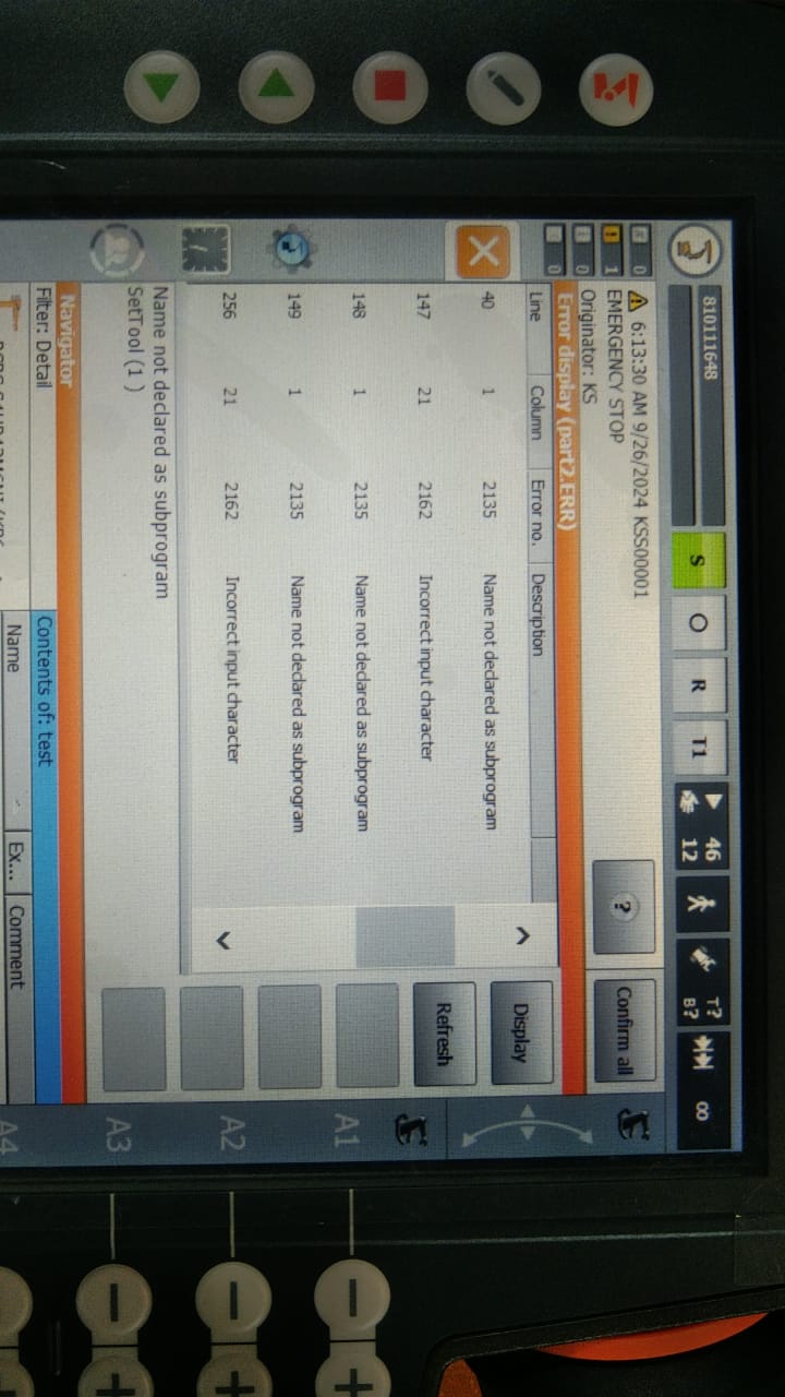

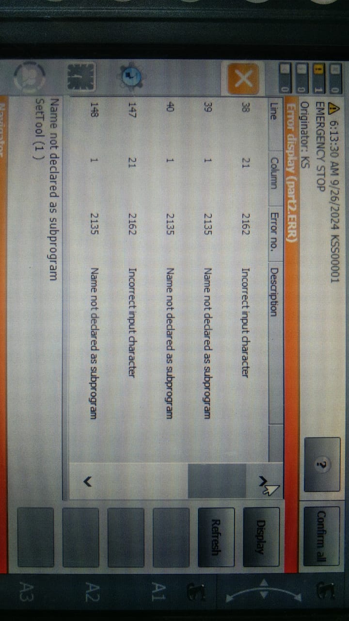

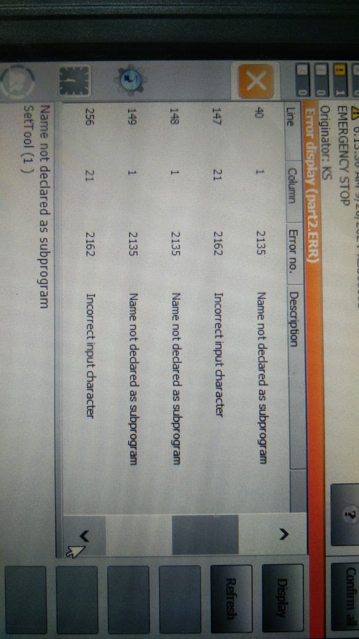

Attached is the errors we receiving now please solve our issue.
Any update  regarding the same
You should remove the SetTool call and any other calls that don't exist in your robot controller to be able to run your program as is. You can do so by removing all program events:
