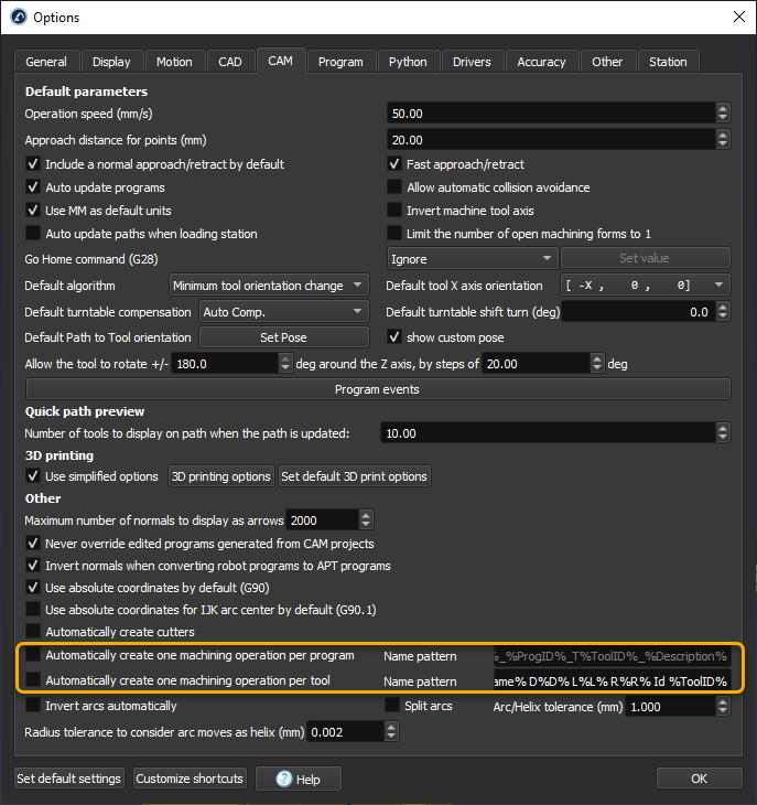

For it to work, you would need to have it split into 4 Robot Machining projects.
You should be able to do so easily by activating this option before importing the program.

I try this functions, but this is don`t work.
I export from the Alphacam, create 4 separate operations, but when exported in RoboDK they are combined into one
