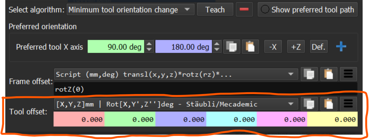

You should be able to use the functions PoseTool and setPoseTool on a robot machining project to retrieve and set the pose of the tool offset respectively.
You can find more information and examples on how get or set robot machining settings from your project here: https://robodk.com/doc/en/PythonAPI/exam...g-settings |
