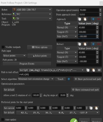

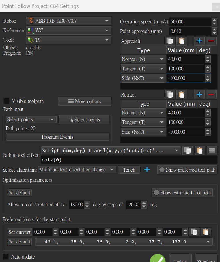

In RoboDK UI, I can add many motion in Approach/Retract section. However, when I use python API, I found there can only add one motion into Approach/Retract section. Is it possible to add multiple motion in to  Approach/Retract section with python API?
I have already checked the example you provided on website and the file installed in local.

Yes, you can add multiple strategies for approach and retract using the RoboDK API to a robot machining project. Simply create a list of strategies using the semicolon symbol.
Example:
from robolink import *
RDK = Robolink()
m = RDK.Item('', ITEM_TYPE_MACHINING)
print(m.setParam("ApproachRetract", "Overlap 10;Normal 10;Tangent 20"))
You can find more information here, including the full list of accepted keywords:
https://robodk.com/forum/Thread-Setting-...hrough-API
And here:
https://robodk.com/doc/en/PythonAPI/exam...g-settings
