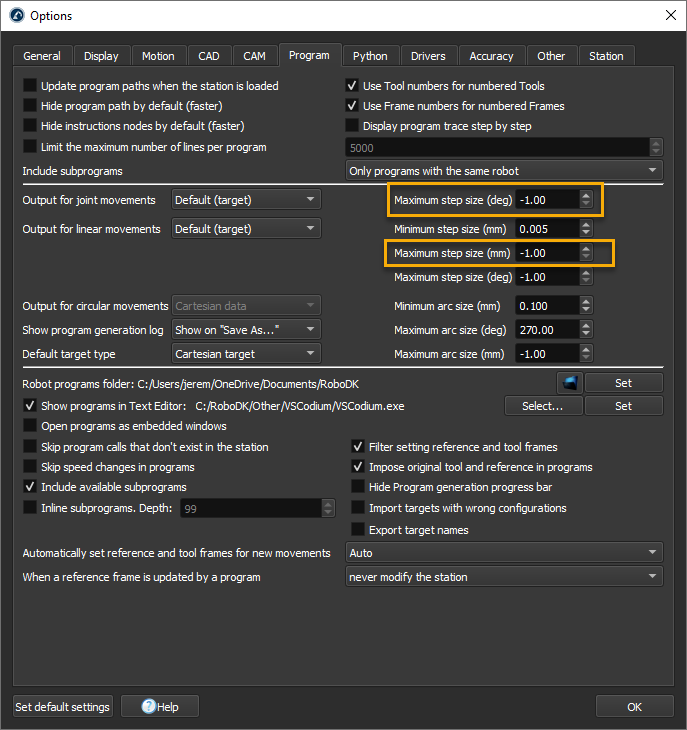

Hi Mats,
RoboDK can split longer paths into smaller ones.
"Tools"->"Options"->"Program"
RoboDK won't warn you though. It will just do it at the post-processing stage.

Thanks Jeremy,
I will try that. I guess the -1 means the function is disabled.

That solved my problem, splits the linear movements as expected.
Thanks
Mats
Hi Mats,
Good, and yes "-1" means "Disable".
