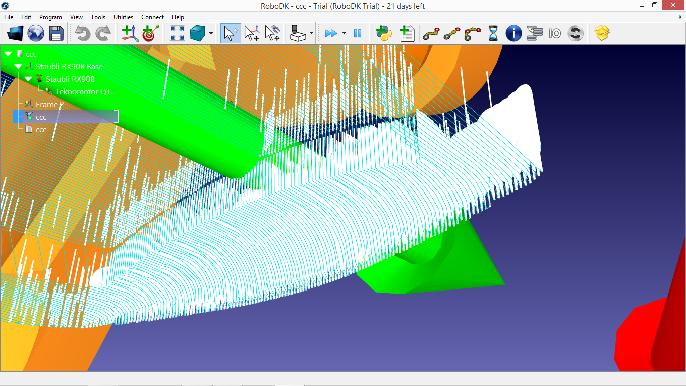

Milling program cutting corners/deviating from Fusion and RoboDK paths
.rdk   ccc.rdk (Size: 4.23 MB / Downloads: 785) Hi Folks,
            I am running into a problem repeatedly on both sides of the mold I'm attempting to machine.  My cutting tool - (1/4" straight router bit) does fine most of the time, but on occasion decides to cut corners as it is descending (and also occasionally ascending) a parallel pass in the shape of stair-steps.  It is cutting off about 5mm of material it shouldn't be removing from the bottom step - on both ends of the mold, often, but not always.
            The strange thing is it only does this in some areas..   It also happened on the flip side of the mold (match plate mold, so it is two sided).  However, it didn't happen as often.
I have tried playing with the continuous path settings - both turned on and off with my robot, as well as running at fast and very slow speeds, and none of those seem to make any difference.   Rounding is set at 1.
There is something happening between the RoboDk simulation and my robot arm that is corrupting the path I need it to take - be that the way the coordinates are post-processed, or the way my arm is reading them.   It's as if it forgets or ignores these areas.  Perhaps some of the movements are supposed to be arcs but are read as straight line movements?
(In Fusion 360)
Both-way milling with both tolerance and smoothing factor set at 1mm.   I imported a grbl nc file from fusion to RoboDk (I don't yet have the plugin for Fusion.  Could that be helpful for this scenario?).
There doesn't seem to be much rhyme or reason as to when it cuts these corners, but it is really messing things up for me.   It is hit and miss - on the x+ end of my piece it often cuts correctly on the u-cut and cuts the corner on the down cut.  But not always.   I end up with a straight line cut as opposed to a convex shape.
Using the Adept V+ custom for Staubli post processor.  This program is about 22,000 lines of code intended to make refining cuts - not finishing.
Any ideas on what could be causing this?  It's quite frustrating and is ruining several days of work.
One thing that is for sure - the path looks perfect in both Fusion and Robodk.  Especially when viewed from underneath the model.
Thanks very much,
David
You can see here the 45 degree straight line that should be a convex rounded curve (often it would cut the curve only to cut it off on the subsequent pass).
Ok,
So I suspect it must have something to do with RoboDk or my robot translating what should be good sized arc movements to straight-line movements. Is there a good way to ask my robot to move in an arc? Or is that not supported with the Adept V+ for Staubli post? I know my machine has the ability to interpolate between different joint positions, and to move in arcs, but it is unclear if it can do that while maintaining the tool configuration. I know the moves command will ask it to move in a straight line whilst maintaining the cool configuration, and that the move command may move in an arc - but possibly not the arc we would ask it to use, and thus, not maintaining tool configuration.
Even if RoboDk's post can't make this translation, I would be curious if I can do it manually as an experiment.
It seems the best option I have right now is to create more points in my path. I tried increasing the tolerance in my Fusion path from 1mm to .2mm, and that seems to have taken care of the problem so far. I was hoping to reduce the number of points to keep my programs shorter, and allow the robot to work more smoothly. A friend of mine who knows these older Staubli robots well suggested that a path with a minimum execution step of 2.5mm may help to run my machine faster and smoother.
Will the plugin for Fusion handle this translation any differently? I am sending my file to RoboDk using grbl / nc format.
Thanks!
