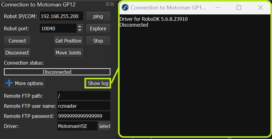

You can retrieve the connection log by r.click on the robot - Connect To Robot - Show Log :
