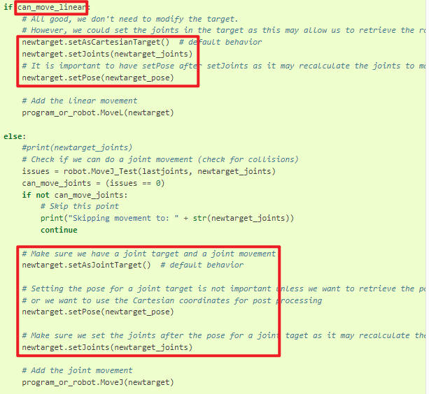

One last question regarding a point in the example you given: Please see the screenshot of the code snippet in the example given. I can understand that, if a linear move is possible, I can set the target as a cartesian target; otherwise a joint target. But what I don't get is that, in the case that a linear move is possible, the code snippet used
newtarget.setJoints(newtarget_joints)
then
newtarget.setPose(newtarget_pose)
As far as I understand, setJoints is not necessary in this case right? I need only setPose in this case. I have tried to remove setPose, keep setJoints, and the code simply does not work.
For the case a linear move is not possible, it's the exactly other way around. So I don't really know why in the example it was written in that way...
