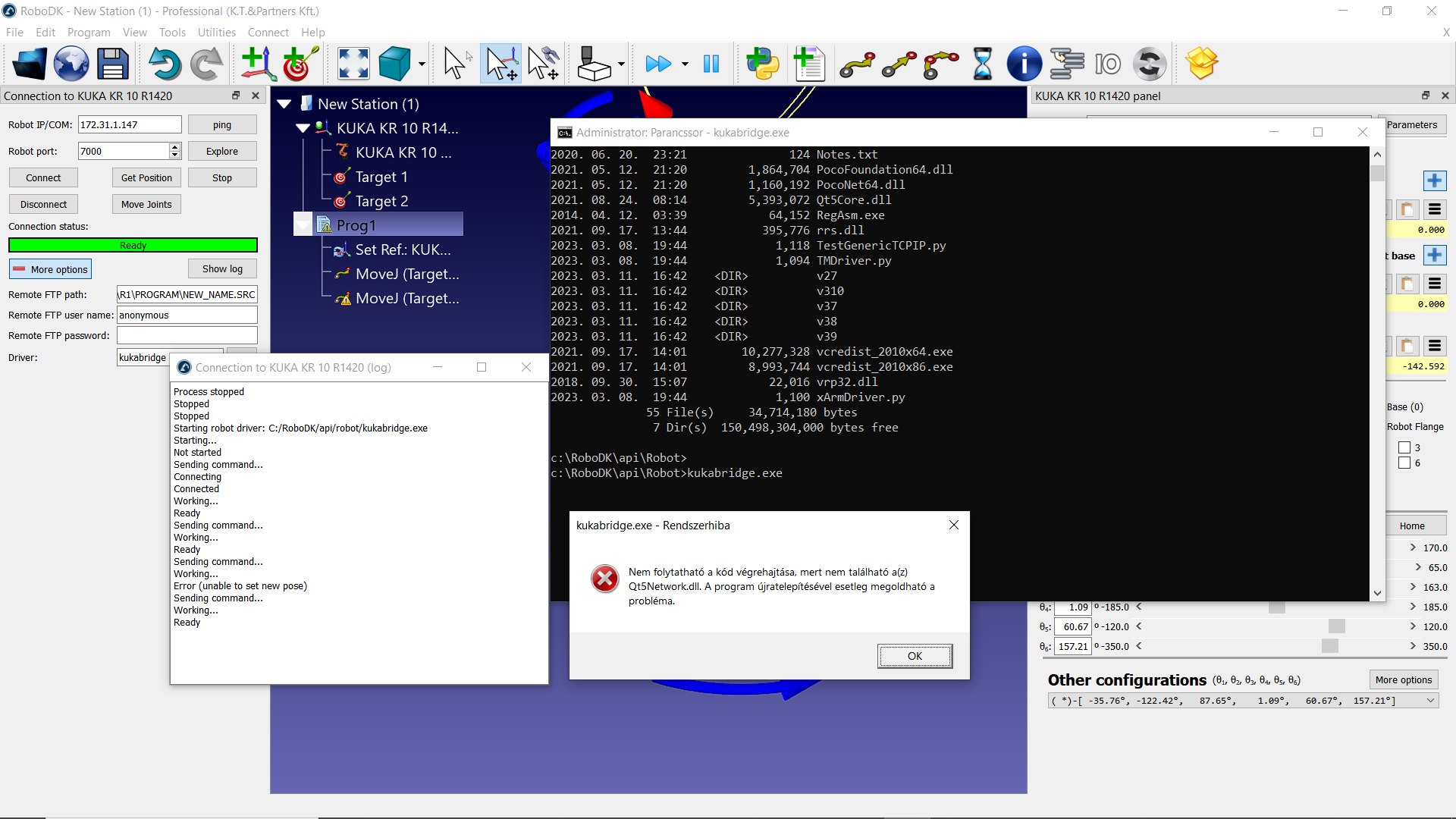

 move joint: "Error (unable to set new pos)
Any idea?

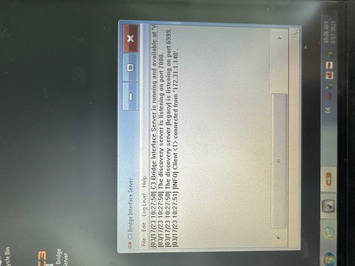

Do you use the C3 Bridge Interface server on the robot control side?
Yes - the c3 program icon is also there on the tray.

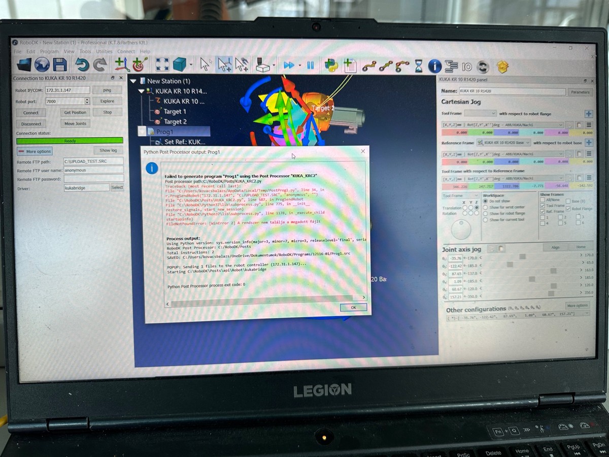

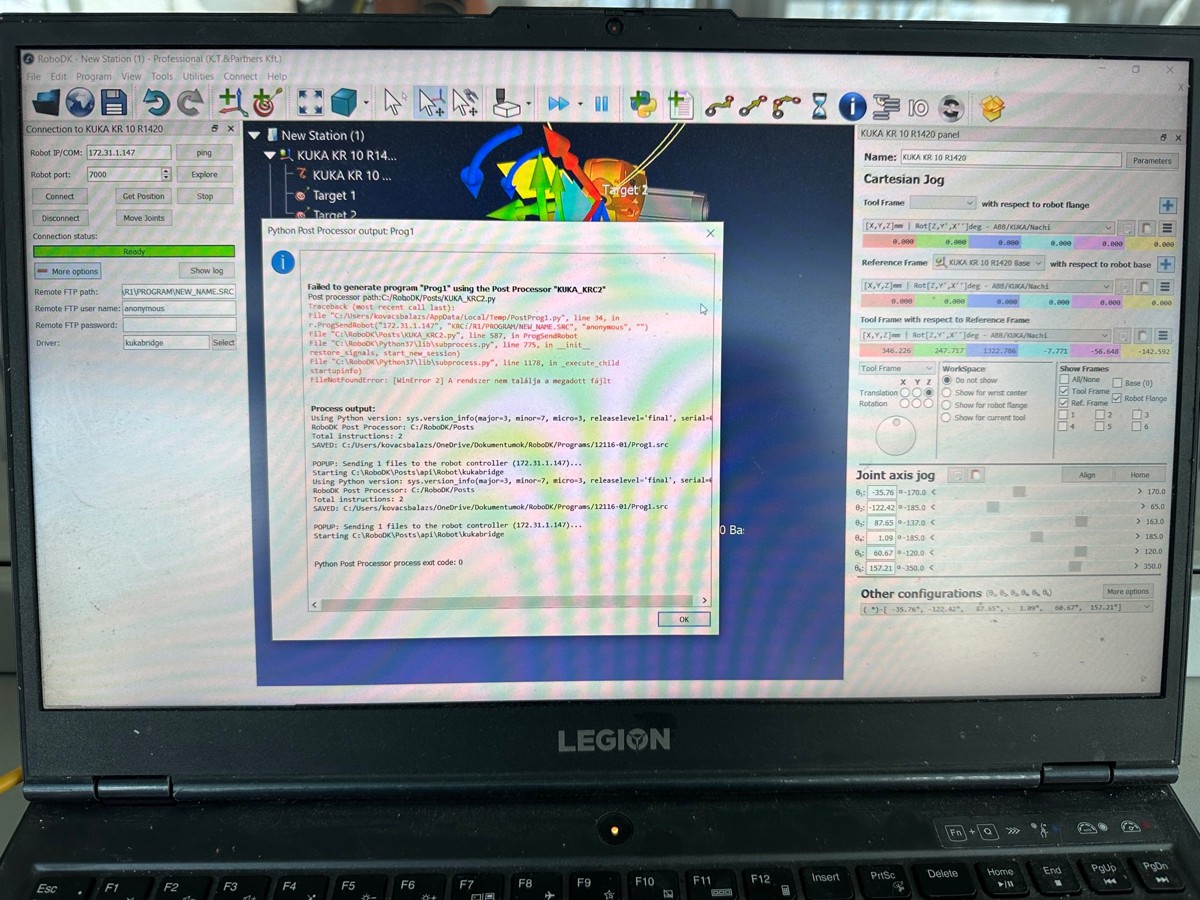

The other message (screenshot) when I wanted to transfer the program to the robot may also be related to the error.
Now we discuss two different problems.
1. The first one is online movement, the Move Joints command.
May I ask you to copy/paste the driver log (you can open it by clicking the "Show Log" button)?

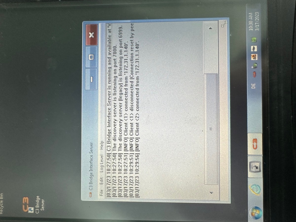

It would also be nice to see a screenshot of the C3 Bridge window at the same point in time.

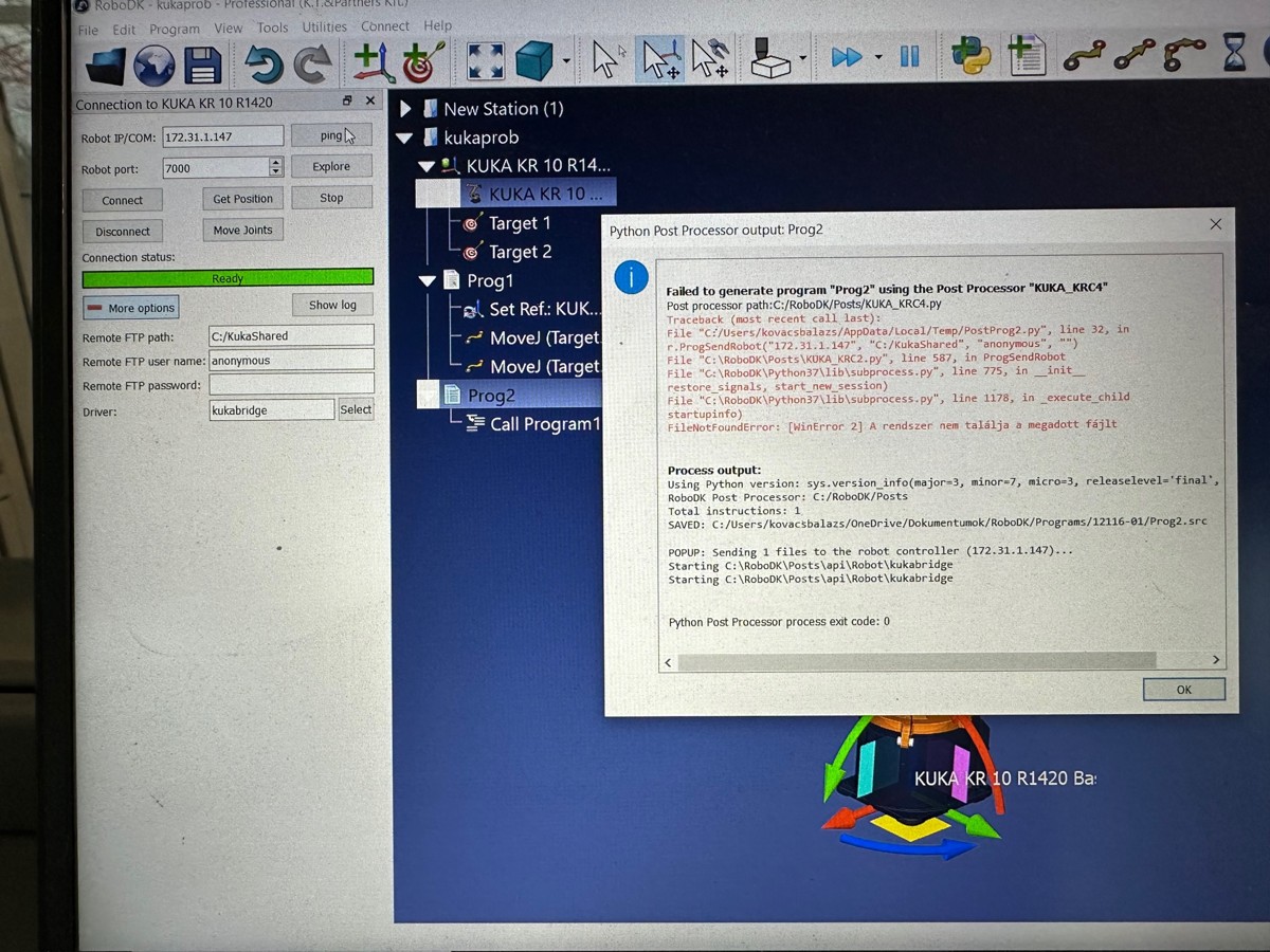

2. The second problem is about invalid destination path on the robot controller.
You're using default value C:/KukaShared, can you try to set valid/existing paths?
Something like:
KRC:\R1\PROGRAM\NEW_NAME.SRC
C:\UPLOAD_TEST.SRC
I attached some screenshots.
This is the connection log:
c:\RoboDK\bin>..\api\Robot\kukabridge.exe
connect 172.31.1.147
SMS:Connecting
Connected
SMS:Working...
SMS:Ready
cjnt
SMS:Working...
JNTS -35.76145 -122.41780 87.65132 1.08980 60.66835 157.21194 0.00000 0.00000 0.00000 0.00000 0.00000 0.00000
SMS:Ready
configure force
SMS:Error (unknown command "CONFIGURE")

Are you sure you didn't forget to replace the kukabridge.exe file after the clean installation?
Because the latest version contains the CONFIGURE command.
