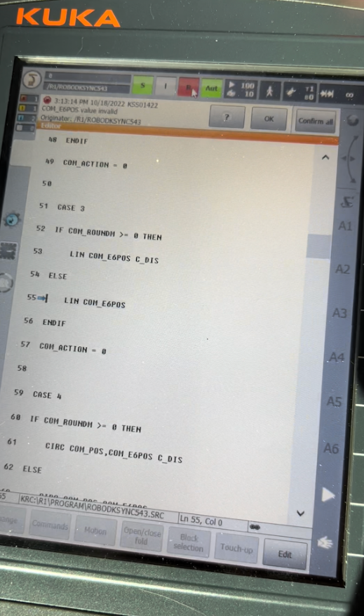

I just got my robot running today and all the MoveJ calls look great. However, when I call MoveL, the ROBODKSYNC543 process on the controller crashes with the error message "COM_E6POS value invalid". I have run this code extensively in simulation and everything works well. I have attached a picture of the controller error message.

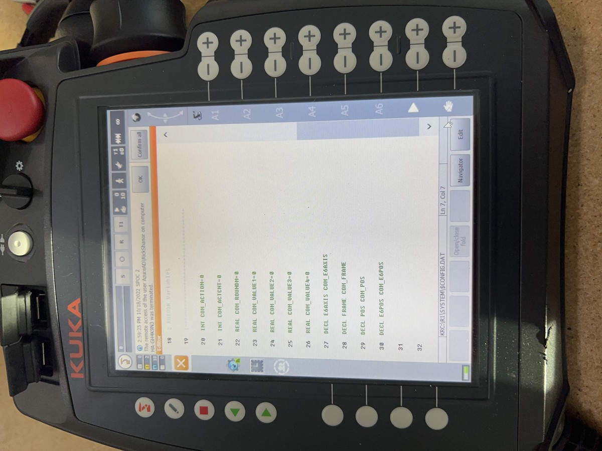

The main issue you brought up (COM_E6POS not defined) happens because you did not declare the COM_E6POS as a global variable.
This line should be in the global definitions KRC:\R1\SYSTEM\$CONFIG.DAT:
DECL E6POS COM_E6POS
We improved the drivers recently so if you followed the configuration steps previously you need to add this line.

I believe I have that set correctly. I have attached both a picture of my $CONFIG.DAT file and a screenshot of the interface when the program crashes. I copy and pasted the $CONFIG.DAT files from the website because at one point I was having trouble with the auto configuration option.
