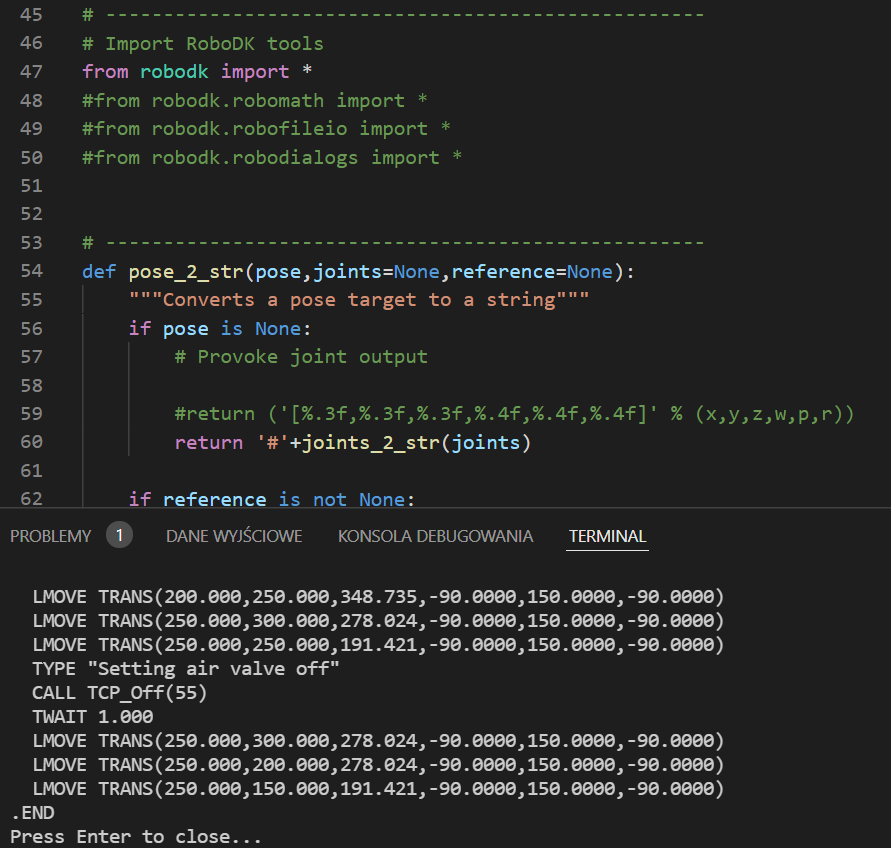

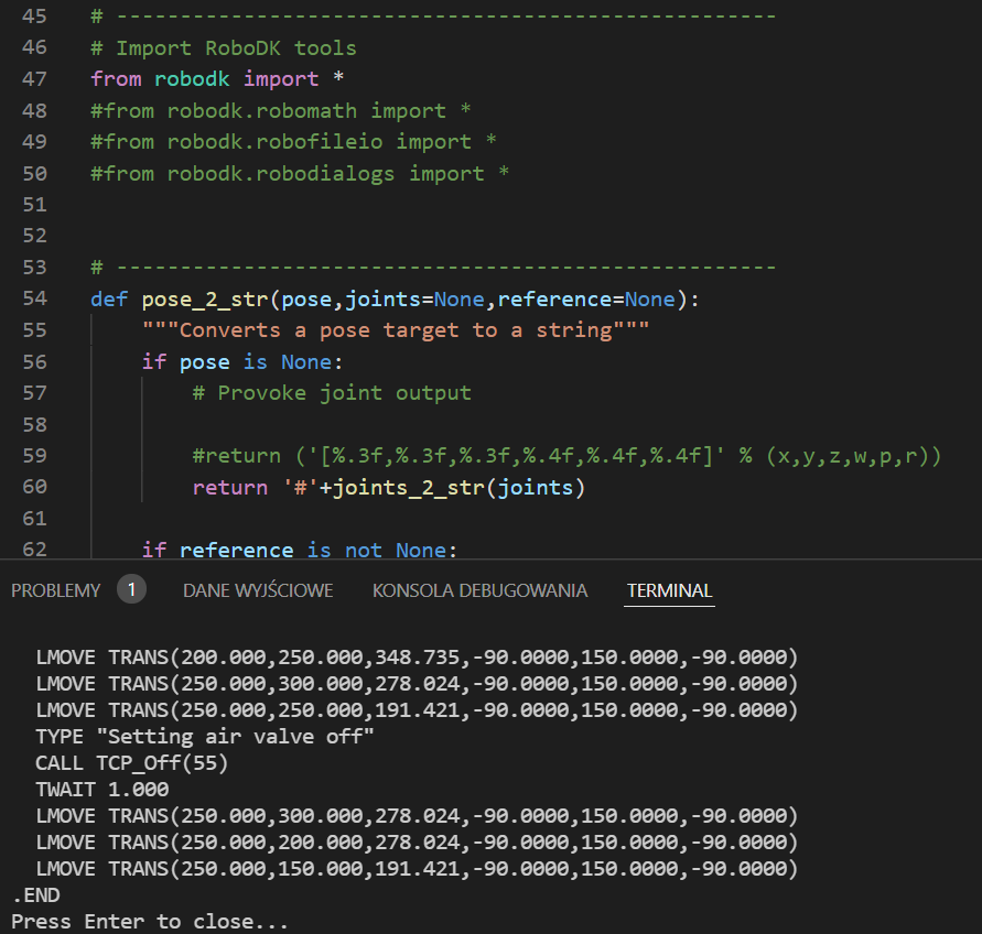

No module named robodk.robomath, robodk is not a package
File "c:/RoboDK/Posts/Kawasaki.py", line 47, in <module>
    from robodk.robomath import *
ModuleNotFoundError: No module named 'robodk.robomath'; 'robodk' is not a package  ????

You can replace line 47 of your Kawasaki.py post processor for this line:
from robodk import *

after such changes it compiles Another question.

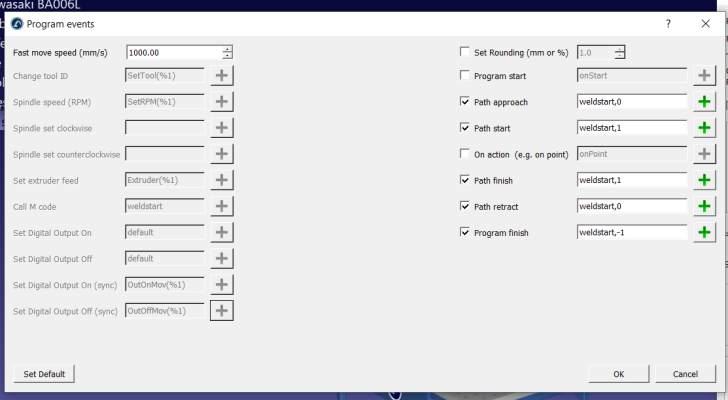

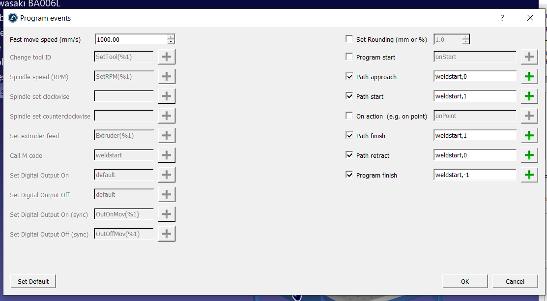

the "def runcode" refers to the "Program Call" of RDK UI.
You can add them either manually or using the curve follow project "Program events".

Just use the keyword weldstart or arcstart as the name of the program called and the post will pick it up.

Hello !!
did i call functions correctly?
In post procecor I do not see adding the command: LWS? (getting to the starting point, arc ignition)
How can I add this feature?
Cheers!
If you own a Professional version under maintenance, you can contact us through "Help"->"Request support". We will help you modify the post-processor according to your needs.
I'm not sure the welding features were integrated into the Kawasaki post.
