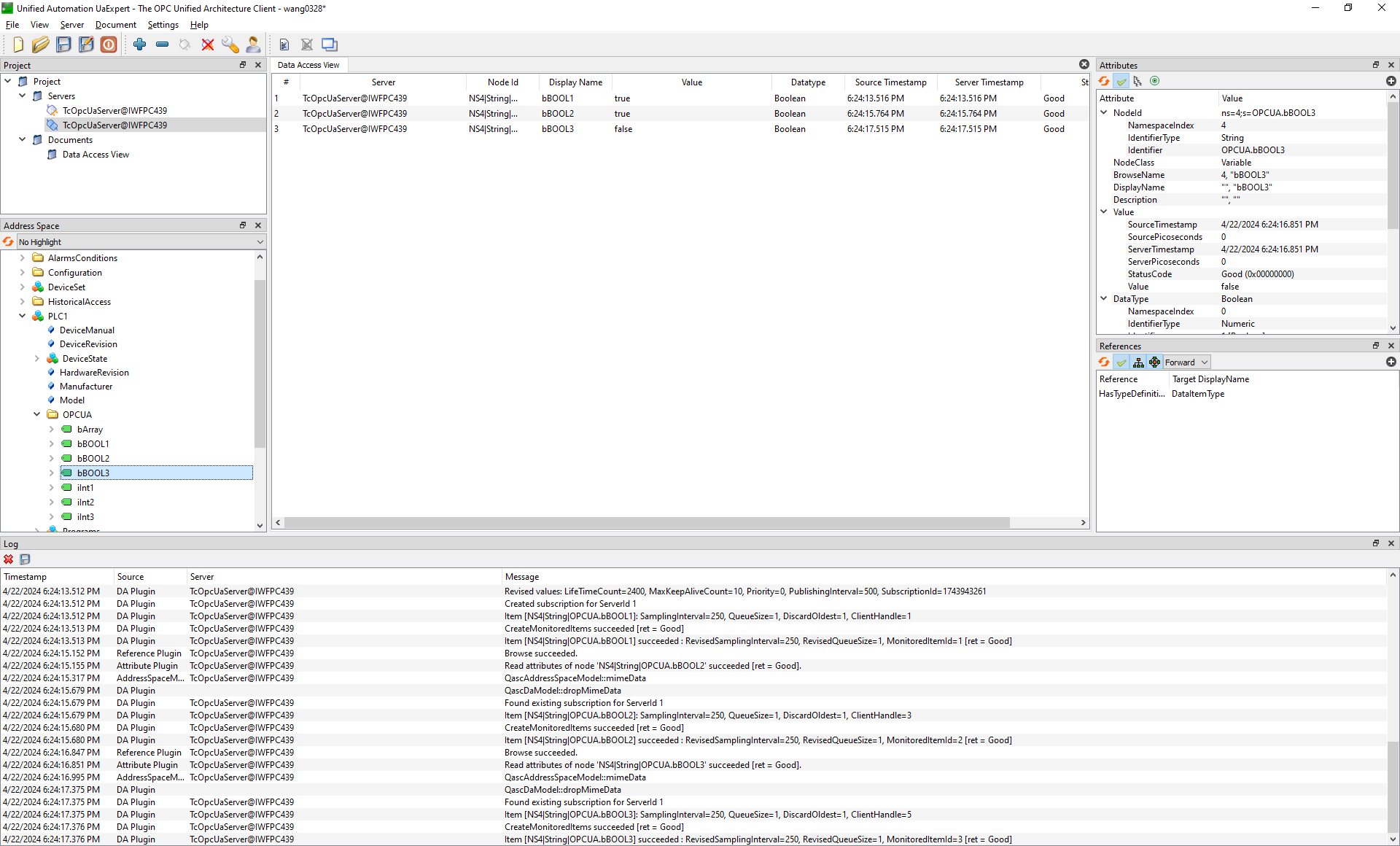

In my project, I want the RoboDK as a Client and Twincat as a Server. My Twincat as a Server can problemlos connect with UaExpert Client. That means my Server is ok. But when I set Twincat as a server or set UaExpert as a server, RoboDK client connot connect.

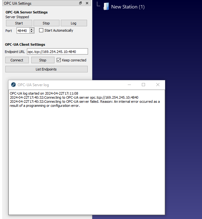

The butten will go green for one second or seconds and then go grey. Two errors will show up when we check the log.
1.This error usually happens when the OPCUA server URL is not correct. It normally does not happen.
2024-04-05T18:41:13:Connecting to OPC-UA server failed. Reason: The network connection has been closed.
2.This error always happens and I usually dont know how to fix it.
2024-04-05T18:35:12:Connecting to OPC-UA server failed. Reason: An internal error occurred as a result of a programming or configuration error

but then I try the url in RoboDK. That didnt work. That will show the error like this.
URL: opc.tcp://169.254.245.10:4840
opc.tcp://localhost:4840
opc.tcp://IWFPC439:4840
These three all work between Twincat and UaExpert and Port 48440 also works.
But they didnt work between Twincat and RoboDK.
But If I set the 4840 in a RoboDKServer and opc.tcp://localhost:4840 in a RoboDK client. That can successfully work, like here.
https://robodk.com/doc/en/OPC-UA.html#ExOPCUA-C
But I think this function can work between Twincat and RoboDK.

After I set the server in Twincat. I have already install OPCUA settings from here  OPC-UA | RoboDK and add it in Tools-Addin-OPCUA. If I want to start the client of RoboDK and click connect
 under the OPCUA Client Settings. Then it will be like the bild named ROBODK. ROBODK.png
But if I use Uaexpert as a client. It can successfully connect.

And Uaexpert connect bild
