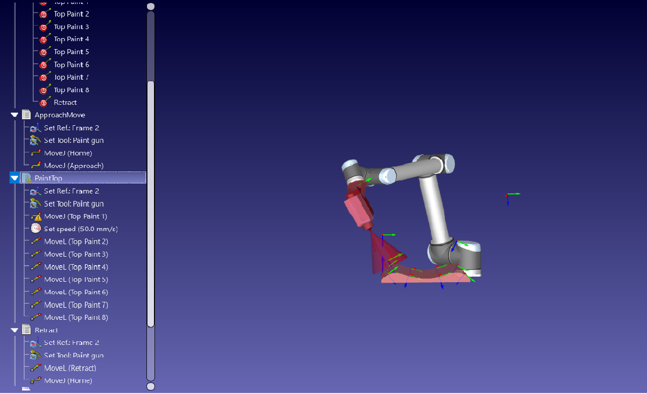

Immagine_RoboDK.png    Hi
I download the program and i try to run the painting example, but they collide in the program PaintTop on MoveJ (Top Paint 1). Thanks for help.
Hi Vincenzo,
You can learn more about the collision detection feature here: https://robodk.com/doc/en/Collision-Avoi...Collisions
If you don't need it, you can simply deactivate it.
Otherwise, you would need to split the Paint Gun 3D model into 2 parts.
The actual gun and the spray.
Once you have both parts, you can modify your collision map to allow collision between the part and the spray.
