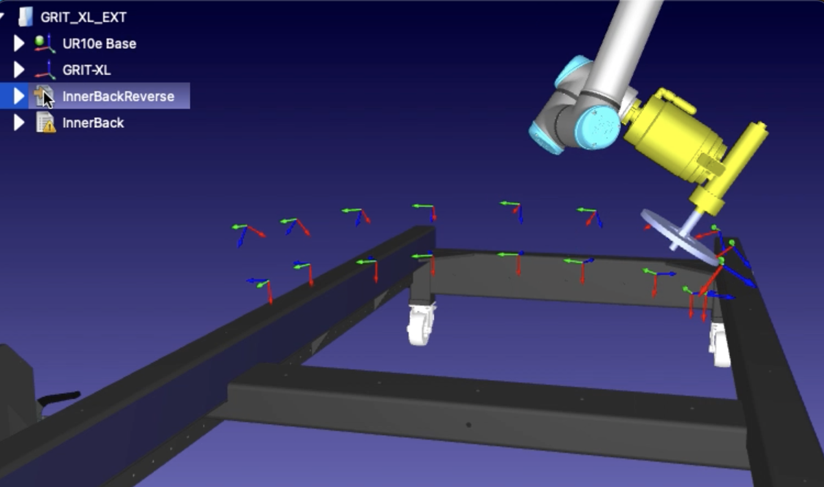

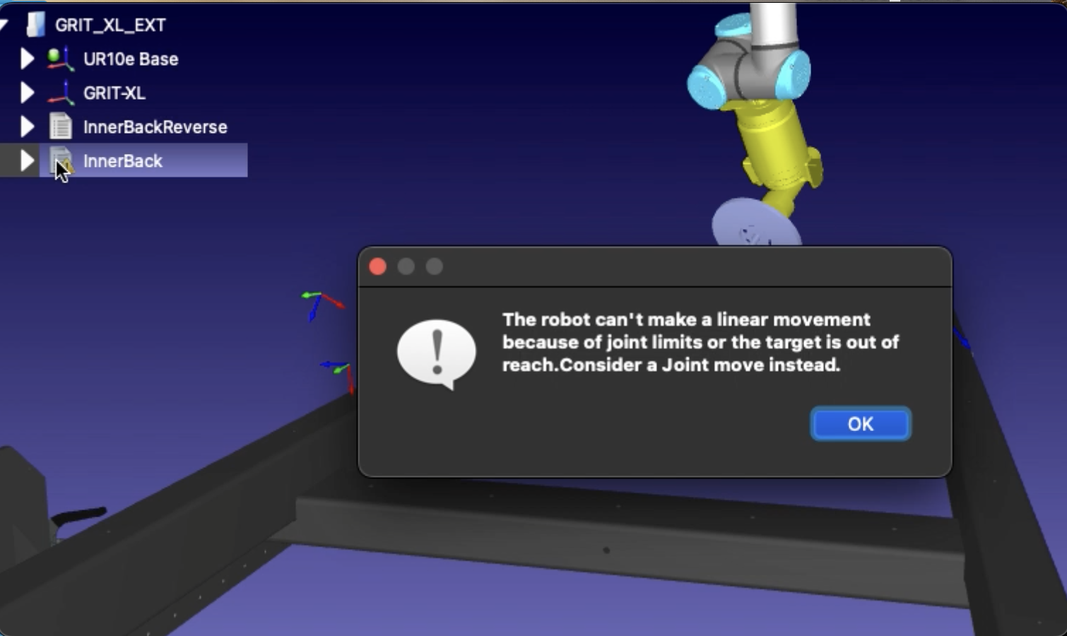

When creating paths from the Target points going from left to right I get an error message:
Error:
However, when creating a path in the reverse order of Target points I get no error:
Is this a bug or some counter intuitive feature of robo physics?
It looks like the robot is trying to change the configuration. If you can share your station, we can take a look.

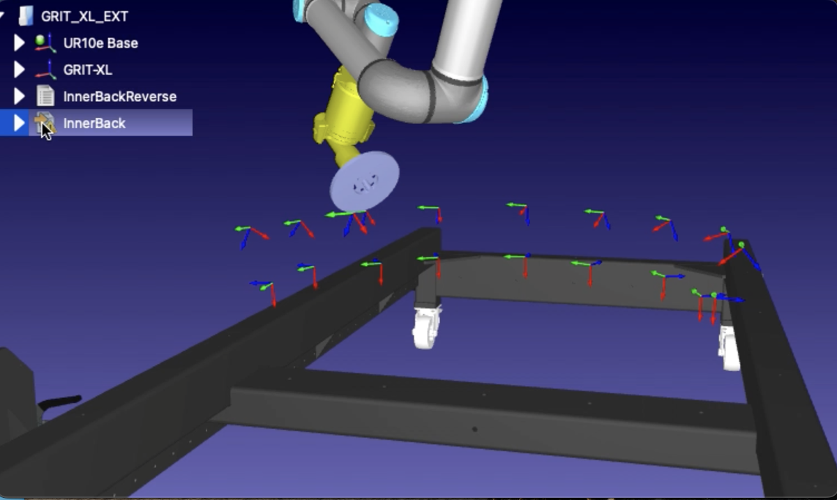

First run InnerBack program to see error
The InnerBackReverse program runs in reverse with no errors.

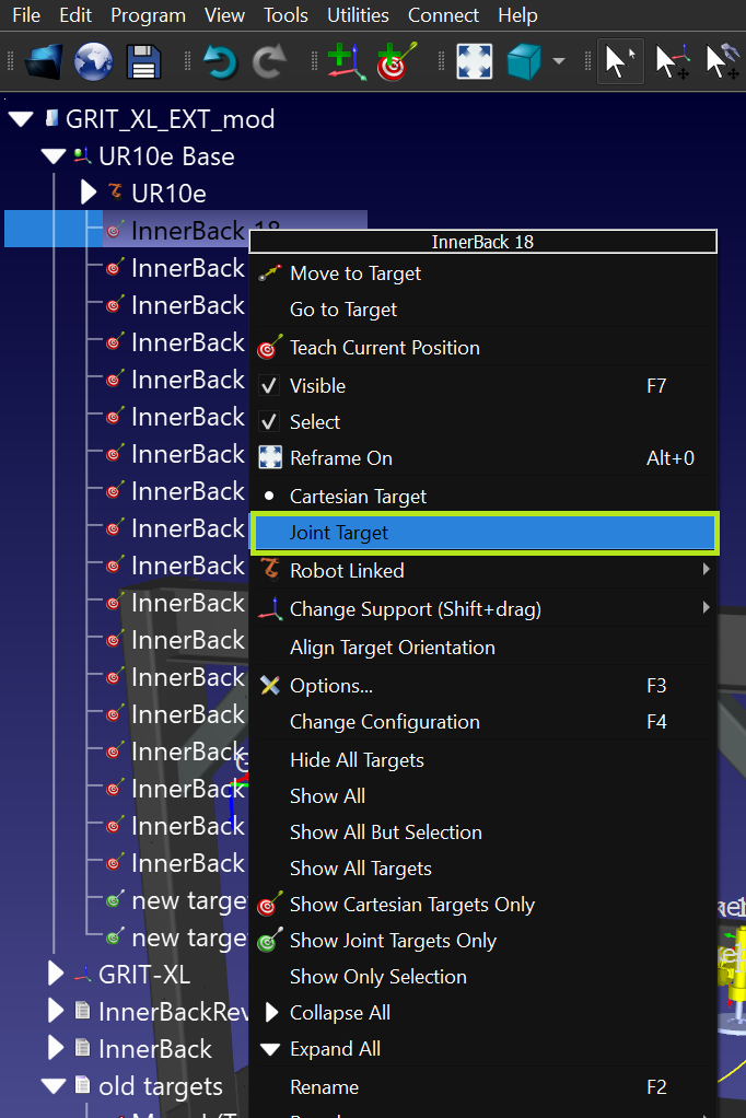

In most cases, I recommend using joint targets with MoveJ instructions. This will allow you to avoid unpredictable configuration changes. I have changed targets 14 and 18 to joint type and reassigned them in your program. Please check the attached station.
