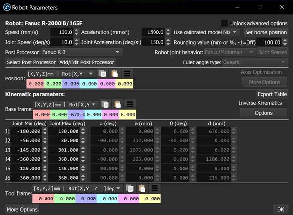

I am having some problems linking a custom post-processor with the actual ls file generated in RoboDK. Somehow the changes I made to the *.py file in RoboDK do not reflect in final '.ls file. Here are some details...
In the latest version of RoboDK, I modified the python file Fanuc_RJ3.py and added the parameters we need to run our robot, see below (specifically the CNT_VALUE):
# set default joint speed (percentage of the total speed)
JOINT_SPEED = '50%'
# set default cartesian speed motion
SPEED = '200mm/sec'
# set default CNT value (all motion until smooth value is changed)
CNT_VALUE = 'CNT100'
# Active UFrame Id (register)
ACTIVE_UF = 6
# Active UTool Id (register)
ACTIVE_UT = 6
# Spare Position register for calculations (such as setting UFRAME and UTOOL)
SPARE_PR = 10
Then, in my Robot Advanced Parameters, I set the post-processor to FANUC RJ3 (in the provided drop-down list) - see attached file. However, when I create an LS file (using this post-processor), the JOINT_SPEED is set at 2% instead, see below:

Can anyone help me identify what I am missing in this whole setup?
