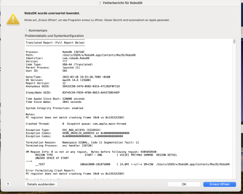

i am using a Mac Sonoma 14.6 and have a problem using the palletizing app. When using either the palletizing or depalletizing the app changes the grab- and place- coordinates to absolutely wrong positions.
When using the "process"-button, the program Robodk gives me the message "unexpected error" and ends the program.

The RoboDK Version is 5.9.0, palletizing app is V1.6.2
This is just a small training object. I first made a pick and place program, everything works like I want it.
When I use the palletizing app and follow the instructions in the documentation, the program doesn't really do what I expected, it to definitely make a mistake here. But I don`t know where my mistake is...

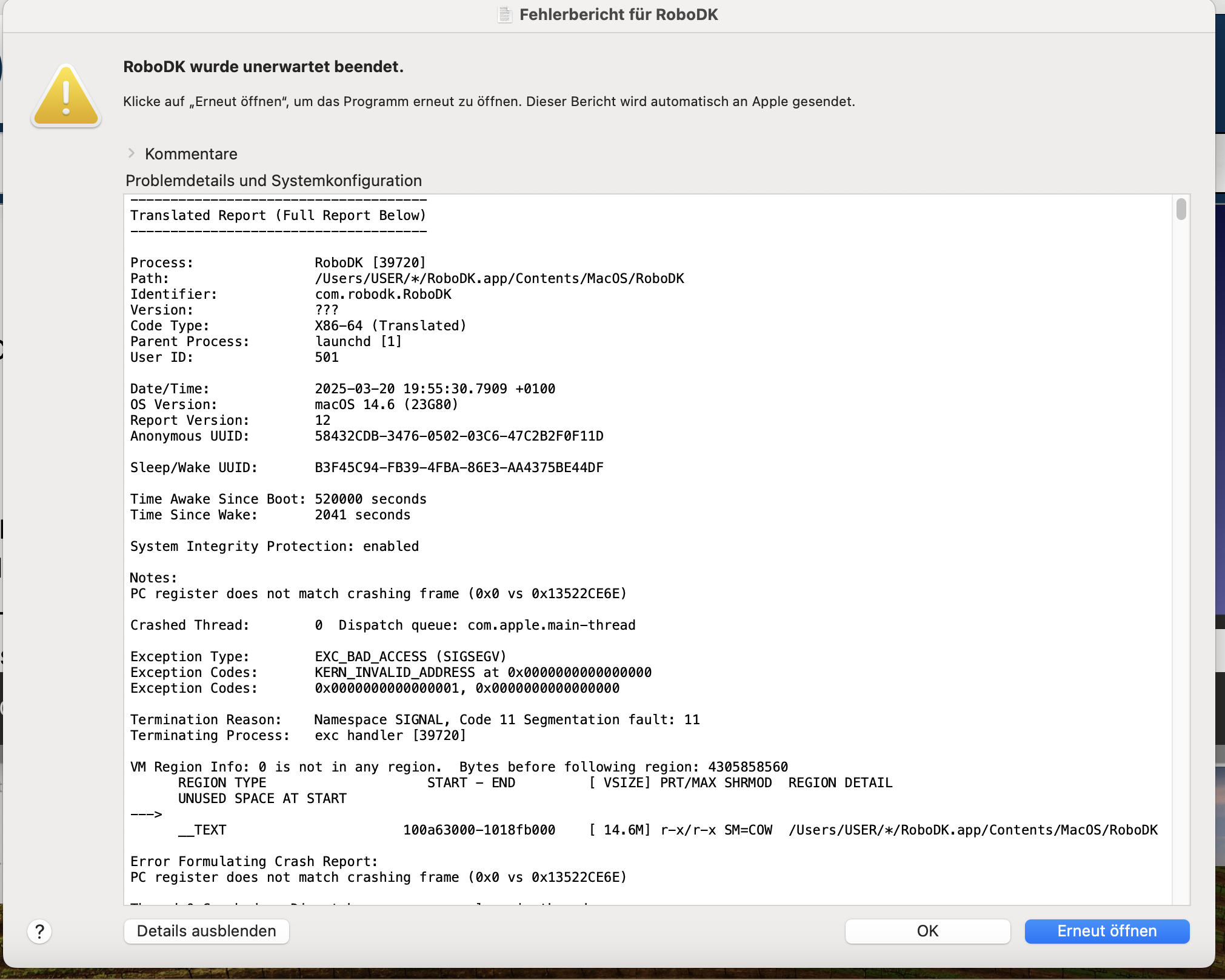

When I start the "project" button, I can chose the input frame. As soon as I want to fill in the output frame, the program closes with the attached message.
