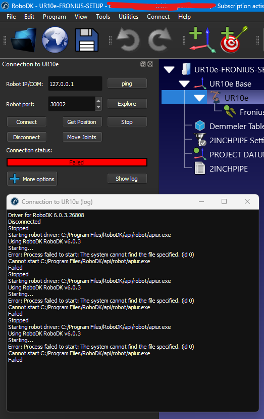

I'm an IT technician assisting one of our staff set up RoboDK and we can't seem to connect to the Robot due to the program unable to locate the drivers. I can manually browse to the file path specified as well as see the full list of drivers in RoboDK.
This is a test installation from my end, the other device has the IP address set to the robot and we are both getting the same result. Our prod version is 5.9.6 and I have also tested the current version, both yielded the same result. I've also tried different drivers all with no success.
We just fixed this issue with the latest version of RoboDK published today (RoboDK 6.0.4):
