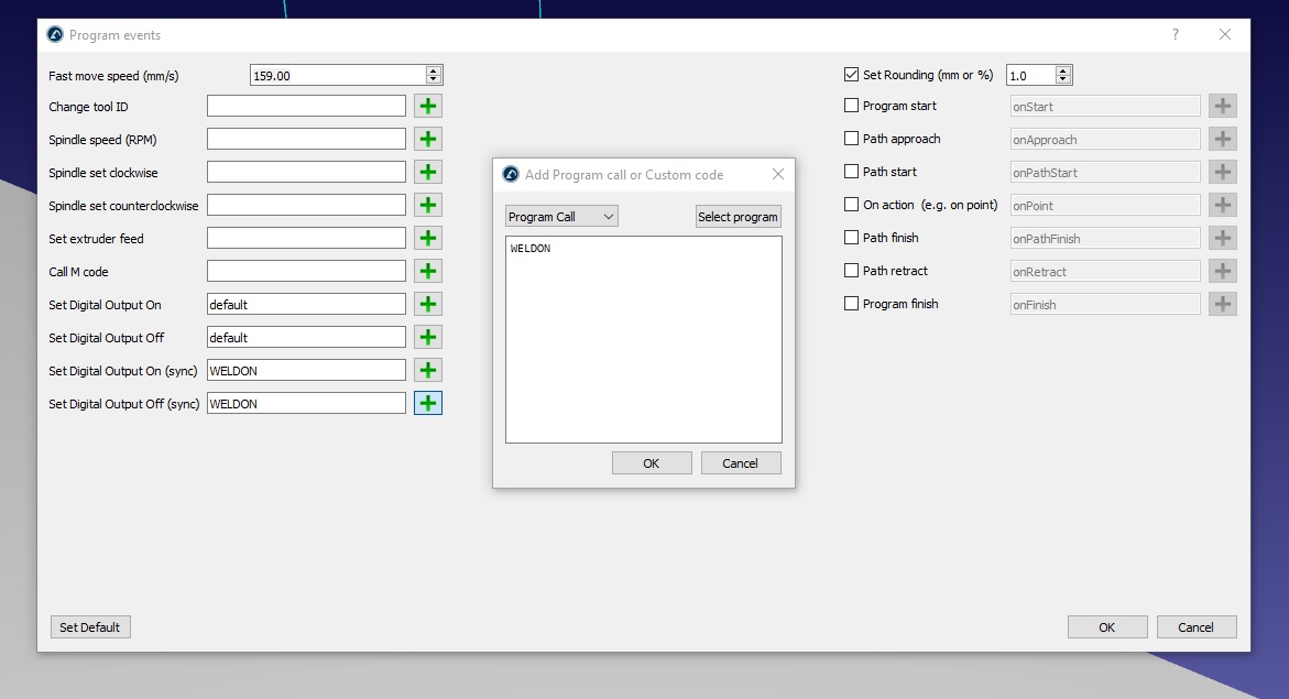

Is there anyway to have a program call in the program events for the fast move speed? When you put a number in and press enter it has a window for a program call but when you select a program it doesn't use it in the robot program.
It changes the Digital Output on/off sync so maybe I would then call this in the post process?
The fast move speed should happen when you have a "Path approach" or a "Path start", could you try that?

The issue is that I would like to of had the option for 2 different m codes coming from the NC program.
I just modified the post-processor for the NC code and now when I flip it to the E101 from the M101 it works with the extruder feed option works great. Then just all the welding settings are in the program call. Now it picks up the ArcStart program call with the E-code and the ArcOFF with the M-code.

The CALL command or CODE would be perfect for what I need. I guess just not sure how to write them in my post for the NC program. When I put them in the code it is always ignored. What am I missing?
I just made a sample program and attached it (see NC file) with these lines in the code and it just skips over them.
N380 CALL LASERON
N390 CODE LASERTURNON
Program events do the programs for ARCON/ARCOFF for simple programs but it would be nice to be able to call a program directly as some of my programs have a few hundred thousand or million lines. The post needs to manage these program calls for sensors between layers.
