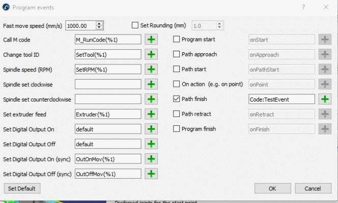

I am using RoboDK for our UR10e, we will be sanding parts with it. The UR is not in our building at this time as it is at our OEM getting the cell for the sanding constructed. I want to output the linear inches of my path to help and set a global variable on the UR, my OEM says that this is possible but has not given me the format of what that need to look like coming out of the UR post processor. I am outputting an apt file from Siemens NX. i have figured out how to change the apt file to output the linear inches of the tool path and i can change it to look how i want but as of now it is just like this, just because i copied the AUXFUN for now

Hi John,
With APT files you can use the commands CALL to provoke a program call and CODE to output any code. The main difference is that when you use CALL, the post processor takes care of generating the code syntax, when you use CODE, you need to provide the full syntax the robot controlller needs.
For example, on a Motoman robot:
CALL Program1 will output CALL JOB:Program1
whereas:
CODE Program1 will output Program1
Other than the GOTO commands you can use the commands provided in this example:

Thanks Guys, I played around with this and it works good, i will just need to wait to see what the output will need to look like in the UR and change accordingly. Thanks again
