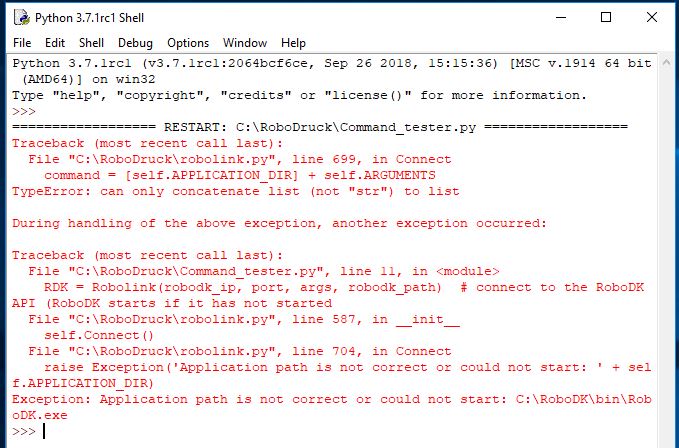

I would like to make a suggestion for an improvement of the Python API reference. What I tried is starting
RoboDK using explicit input values (although these are the default values):
It raises a type error stating that a concatenation of list and string is not possible (see attachment). Looking into robolink.py it becomes clear that the inputs of robodk_path and args are being concatenated. Where robodk_path is transformed to a list automatically, args is handed over as it is declared in the first place (see attachment), in this case as a string.
The correct version of the code above would be:
It is really not a big deal but it might be worth mentioning that command line arguments should be given as list:
https://robodk.com/doc/en/PythonAPI/robolink.html
Best Regards
David
robodk_ip='localhost'
port=None
args=''
robodk_path='C:\\RoboDK\\bin\\RoboDK.exe'
RDK = Robolink(robodk_ip, port, args, robodk_path)It raises a type error stating that a concatenation of list and string is not possible (see attachment). Looking into robolink.py it becomes clear that the inputs of robodk_path and args are being concatenated. Where robodk_path is transformed to a list automatically, args is handed over as it is declared in the first place (see attachment), in this case as a string.
port=None
args=[]
RDK = Robolink(robodk_ip, port, args, robodk_path)It is really not a big deal but it might be worth mentioning that command line arguments should be given as list:
Best Regards
David
