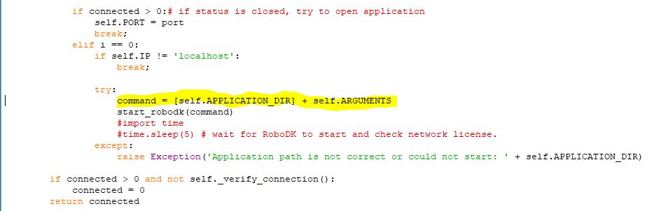

I would like to make a suggestion for an improvement of the Python API reference. What I tried is starting
RoboDK using explicit input values (although these are the default values):
robodk_ip='localhost'
port=None
args=''
robodk_path='C:\\RoboDK\\bin\\RoboDK.exe'
RDK = Robolink(robodk_ip, port, args, robodk_path)
It raises a type error stating that a concatenation of list and string is not possible (see attachment). Looking into robolink.py it becomes clear that the inputs of robodk_path and args are being concatenated. Where robodk_path is transformed to a list automatically, args is handed over as it is declared in the first place (see attachment), in this case as a string.
The correct version of the code above would be:
port=None
args=[]
It is really not a big deal but it might be worth mentioning that command line arguments should be given as list:
https://robodk.com/doc/en/PythonAPI/robolink.html
Best Regards
David
Hi David,
Thank you for letting us know. We just updated the documentation.
We also improved this function to accept strings with the latest version (Windows 64 bit only, for now). Providing a string will behave as one argument (even if you have one or more spaces).
