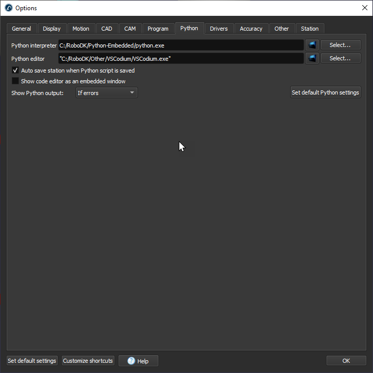

If you have problems generating robot programs, it is most likely related to the Python interpreter.
Make sure that the Python interpreter is valid: RoboDK->Tools->Options->Python.
(08-31-2023, 01:13 PM)Sam Wrote: If you have problems generating robot programs, it is most likely related to the Python interpreter.
No i don't think so. It is set to the default embedded python interpreter and the code executes just fine and the robot moves in the simulation.

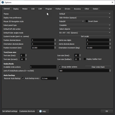

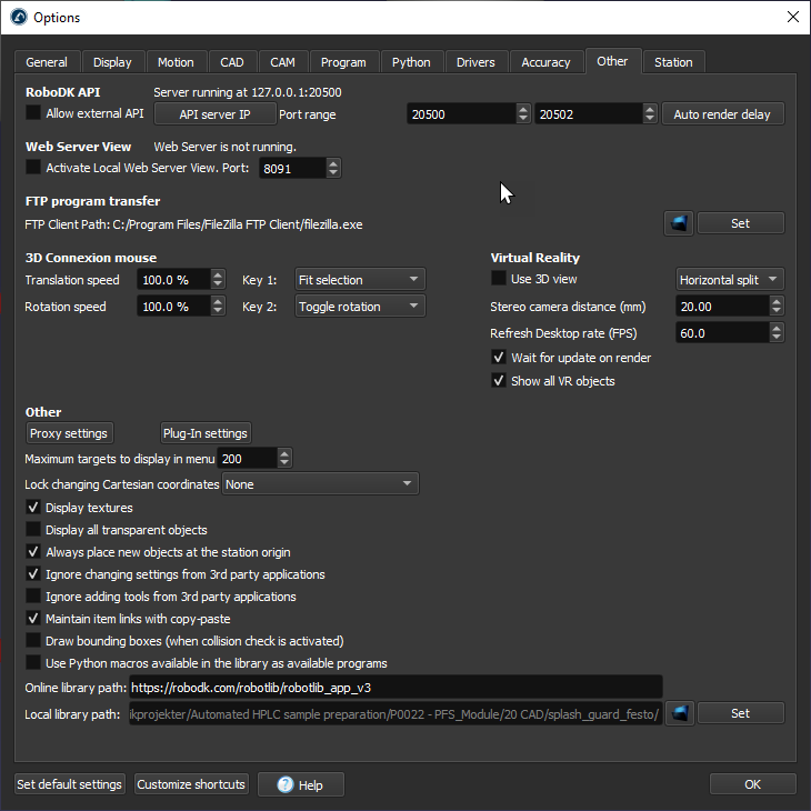

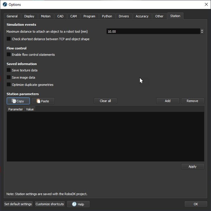

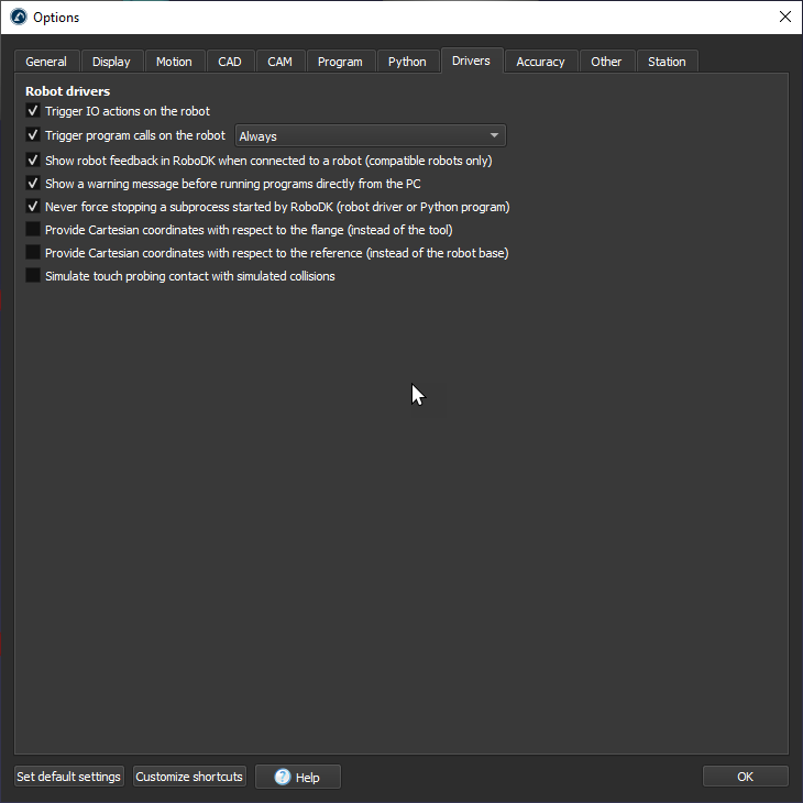

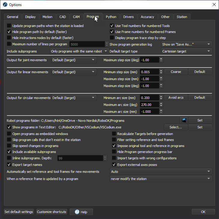

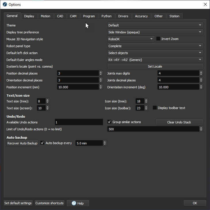

regardless i have now here uploaded a sample station where it doesn't work as well as screenshot of my settings in roboDK. The station will most likely work just fine for you, but for some reason when i generate the python script it just executes it and then nothing more happens. I do not get the generated output.
2023-09-14_11-03-37.png    2023-09-14_11-04-26.png    2023-09-14_11-03-58.png    2023-09-14_11-04-05.png    2023-09-14_11-04-12.png    2023-09-14_11-04-19.png
