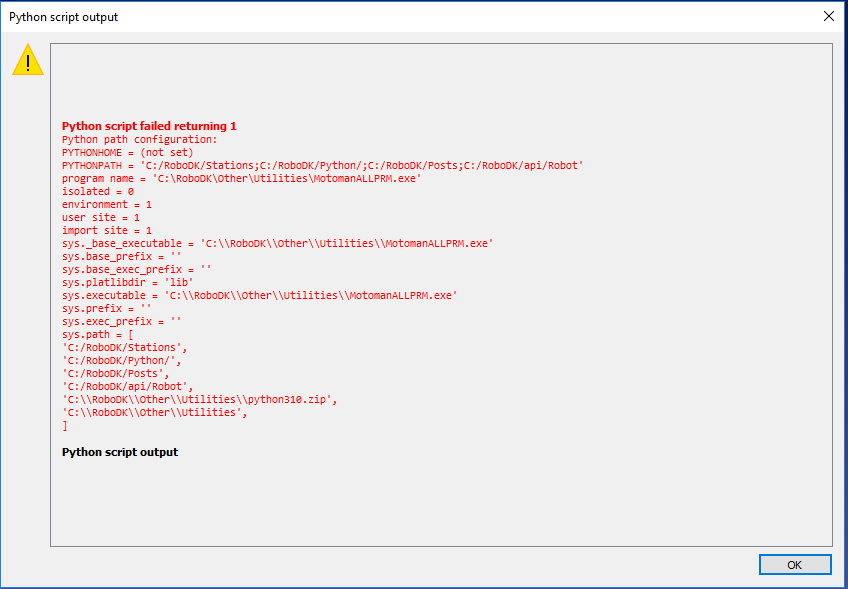

I am trying to import a all.prm parameter file from my motoman DX100 controller for a new roboDK setup. Whenever I attempt to import it, I get an error saying pything script failed returning 1 with additional error output which can be seen in the attached image. I am running robodk v5.8.0 and am using the embedded python interpreter. Thanks in advance for the help!

If you can share the robot and all.prm files, we can try to update the pulse values on our end.
