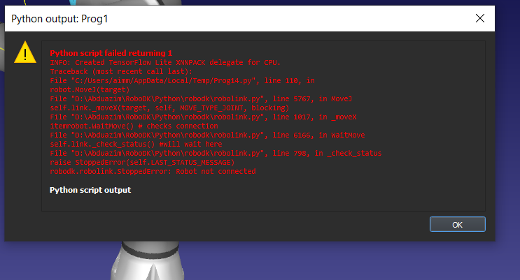

Hi dears, I have an issue when I am sending my Robodk python program to my URe5 robot. It is hand gesture program in python it is working in RoboDK but when I am sending to my robot is showing some error in python script.

the error mentions the robot is not connected. Were you able to successfully ping the robot?
How are you transferring the program? Python Programs can not be transferred to robot controllers.
You might want to take a look at setRunMode()
https://robodk.com/doc/en/PythonAPI/robo...setRunMode
