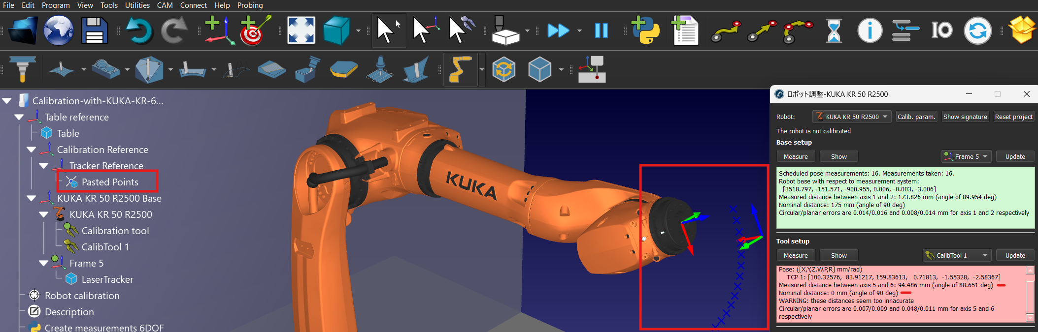

I believe the main issue with this project is that the SMR target happens to be attached too close to axis 6 (the nominal Tool X and Tool Y values are too close to 0 mm). You should move the target a bit further away from axis 6 to properly identify the robot flange. RoboDK finds the TCP based on identifying the intersection between the virtual axes 5 and 6 and applying the offset by the nominal distance.
Just applying an offset of 20 mm is enough. This can be done temporarily only for the tool measurements that move joint 6.
You can troubleshoot measurement issues by simply copy pasting a group of 3xN points.

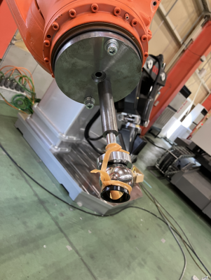

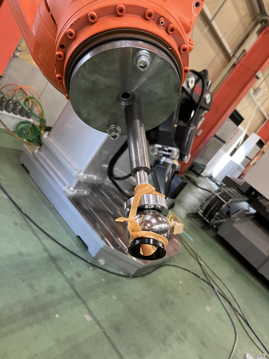

Can you share a picture of the calibration setup? More precisely, how the SMR target is attached on the robot end effector.

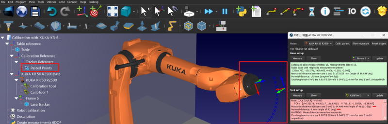

Thank you for your explanation. It was very helpful.
Based on your advice, we have modified the SMR setup as follows:
- The SMR target was originally mounted almost on the axis 6 centerline, approximately 160 mm along the tool Z axis from the flange.
- We have now applied an X/Y offset of about 20 mm from axis 6, only for the tool measurements that involve joint 6 rotation.
After applying this offset:
- The tool calibration result is now shown in green.
- The estimated Tool XYZ values are close to our expected values.
However, we still observe the following:
- The base calibration is shown in red.
- After running the adjustment, the result remains “insufficient pose coverage” and the final error is 0.
- The result does not change compared to before the offset.
We have attached a picture of the calibration setup, showing how the SMR target is mounted on the robot end effector.

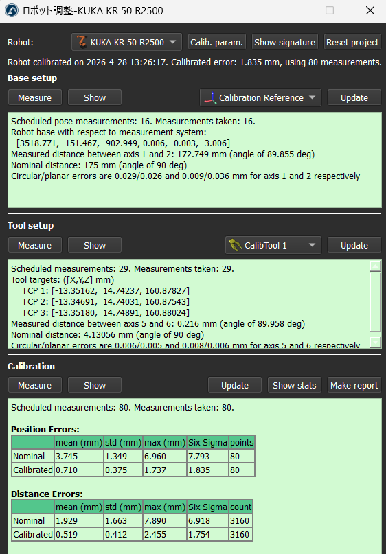

.rdk   Calibration-with-KUKA-KR-6-R700-sixx2.rdk (Size: 5.59 MB / Downloads: 176)

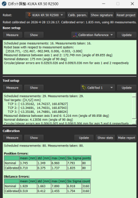

The new project looks better and you took proper measurements this time.
However I see 2 separate topics that need to be clarified/fixed:

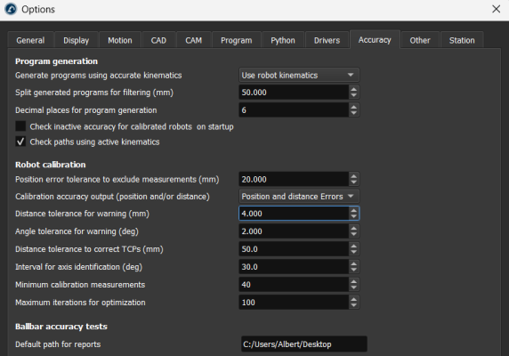

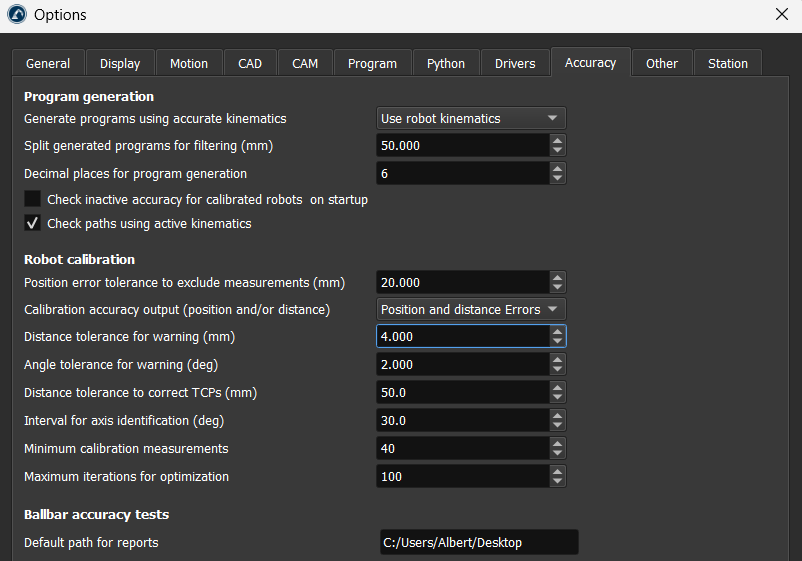

  1. The base setup looks good even if it is red: When the measurements data is shown in red is because a tolerance is exceeded somehow. In this case, there is a default 2 mm tolerance that is exceeded when measuring the nominal distance between axes 1 and 2. You can change this tolerance here: Select Tools-Options-Accuracy and set Distance toelrance for warning (mm) to 4 mm. Changing this tolerance has no impact on the results or how RoboDK uses this data. This is simply to show a warning.

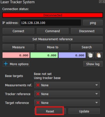

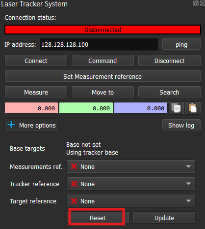

  2. You used the Set Measurements reference option whe using the laser tracker only for the calibration measurements (you didn't use it for the base setup and tool setup). I strongly recommend you to not use this option unless moving the tracker during the calibration procedure is a requirement. I manually edited the calibration data you took to remove the base frame definition so it uses the tracker reference (the first line of the CSV meausrement data should be all zeros).
I attached your project with the correct calibration data. This calibration with these 2 edits should be valid. In your case for this project we can see a position improvement from 3.7 mm to 0.7 mm.
See attached images.
On the other hand, for a robot like the KUKA KR 50 R2500 (50 kg payload, 2500 mm reach and 0.050 mm) I believe we could get even better results (0.4 mm position error probably). Here are some ideas that can help you troubleshoot if you want to repeat the calibration to see if you can obtain better results:
  1. Did you warm up the robot and the laser tracker?
  2. Did you wait enough time for the stabilization before taking the measurement? I would recommend 5-8 seconds. You may be able to feel the robot vibrate after it reaches a target.
  3. Is the robot in a warehouse environment? If so, is the laser tracker close to air currents or temperature variations? Laser trackers are very sensitive to air currents and temperature changes. The measurement can vary by 0.1 mm even if the repeatiblity of a tracker should be under 0.02 mm.

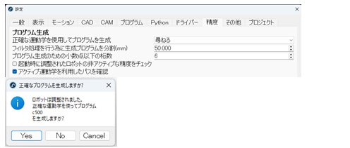

However, when generating robot programs in RoboDK, we observed that the output position data does not change regardless of whether we select “Use accurate kinematics” as Yes or No.
Could you please confirm whether this behavior is expected?
Also, we would appreciate it if you could let us know how to properly enable or verify the calibration effect in the generated programs.

I confirm your progras only have joint movements. Also, if you generated a program for ballbar testing they won't be filtered either.

The automatic splitting is necessary to compensate the points along the way (50 mm tolerance by default). You can disable it in Tools-Options-Accuracy.
