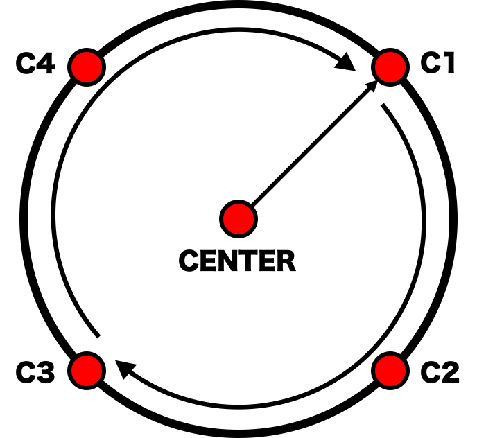

Recently I'm doing a project making the robotic arm drawing full circles on specific plane.
The trajectory is shown in the picture down below.
The arm will start moving from the center to point c1 with MoveL command.
Then finish the circle with two MoveC commands from c1 to c3 and c3 back to c1.
However, there will always has a short slight stop between MoveC commands while running on RoboDK.
While running on the robot, the short slight stop becomes an abruptly stop.
Is it possible to make a smooth full circle in RoboDK?

Thanks for the replied!
That solved the problem!
