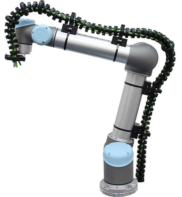

I got a simulation task which UR and cable management(the concept are as below ) , how can i simulate the cable to avoid cable collision and twist .

You can't simulate cable management realistically within RoboDK. There's two things you can do though. 1 - Restraint your robot joint limits to make sure the cable doesn't get too twisted. To do so, open the robot panel and double-click the joint limits near the bottom of the window. 2 - You can create a new UR robot with the cable included as part of the robot model. You can see an example by downloading the Kuka KR 60-3 from our library. That will help you avoid collisions. You can learn how to build a custom robot here: https://youtu.be/wZQ0uriwApY Simply download the 3D model of a UR robot from there website and add the cables on top. Jeremy
