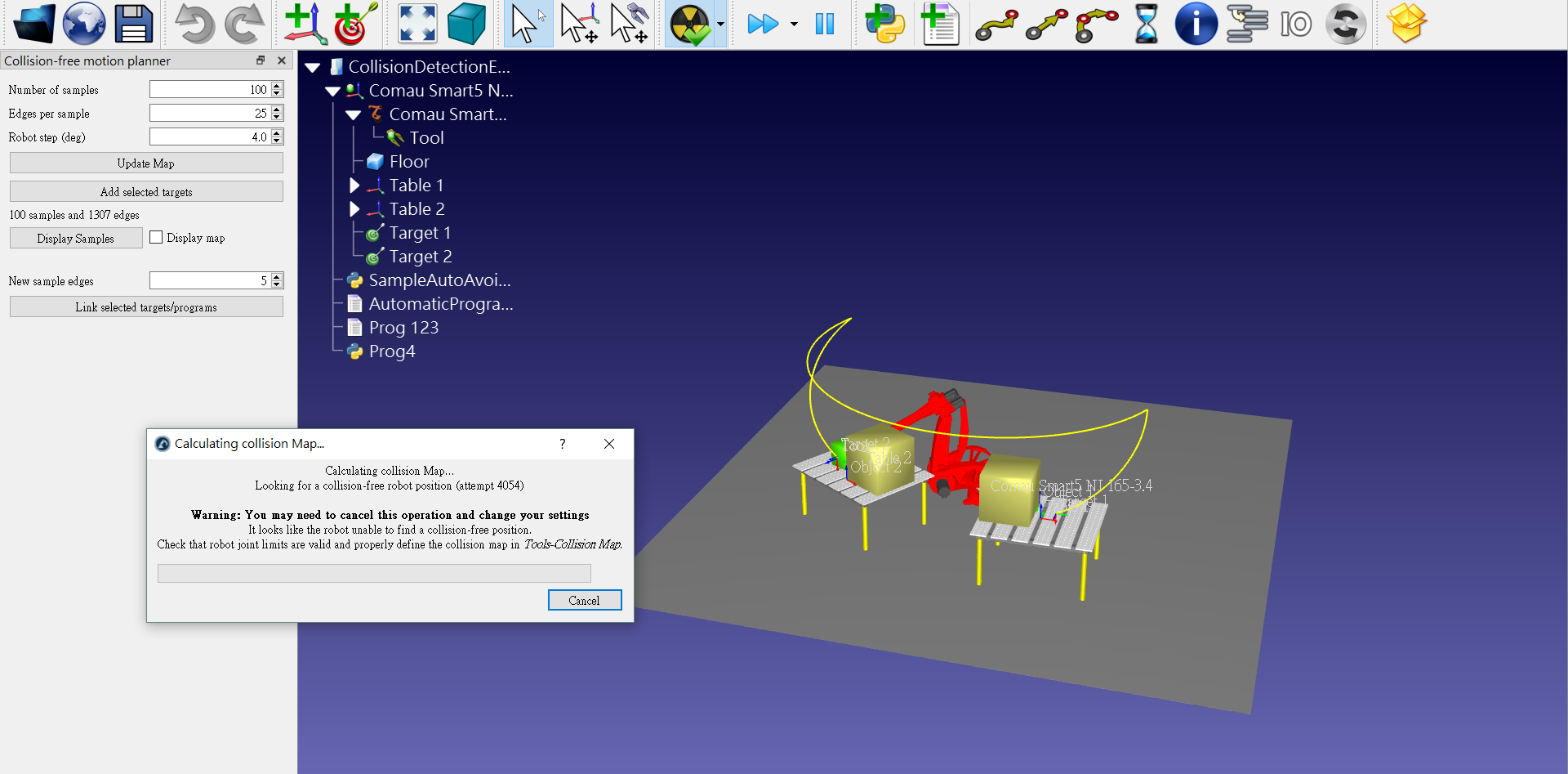

I'm trying to create a collision-free-map these days (my version is 3.8.4 now), then I have some questions:
First,
I follow the RoboDK documentation (https://robodk.com/doc/en/Collision-Avoidance.html#CollisionPRM) to create the collision-free-map step-by-step, but the calculation didn't success. (I tried many times, no matter how long did it take, it didn’t success.)

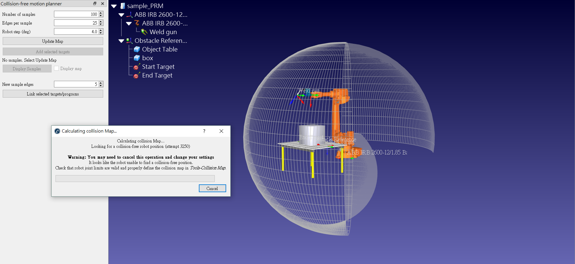

Then I searched and saw this discuss about the collision avoidance(https://robodk.com/forum/Thread-Collision-Avoidance), so I downloaded the sample rdk file and tried to execute “update map” , but the calculation still failed.
Another question, when I opened the sample rdk file, only try to check “display map”, then I got the interruption of program, why these problems came up?
https://gph.is/g/Z7noV82(the GIF of interruption)
I already uninstall my RoboDK one time, but it's still the same.
Thanks for helping.

Hello Albert,
I go to check my update again,
I think I miss  the latest version update,
Now I update to  the latest version then it seems work successfully.
Thank you very much for helping.
