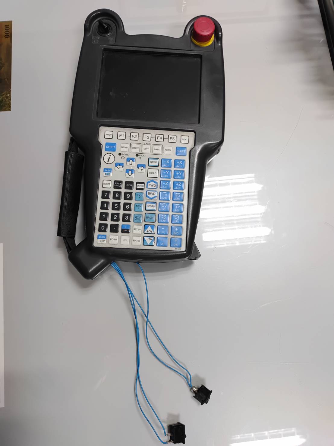

After trying some methods, I found a method to use the robot.runinstruction() function.  I wired the Teach Pendent with 2 switches to silumate the DEADMAN is pressed, so that I can use the function at T1/T2 mode.  It is quite unprofessional, but it can solve my problem  in short-term.
