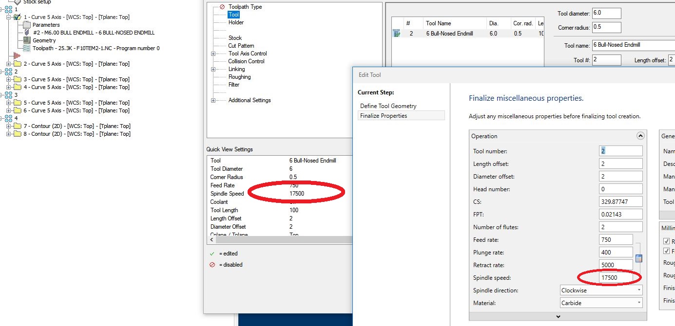

 When I am doing a machining program and set the tool parameters (RPM, etc.)
, when I move to RoboDK it changes the RPM speed, why?
Whatever the RPM speed, RoboDK increases by 10 percent.
How can I solve this problem. The robot I am using is ABB4400-45 and the post is ABB_RAPID_IRC5.
 I send 2 images and the .NCI file created by Mastercam.

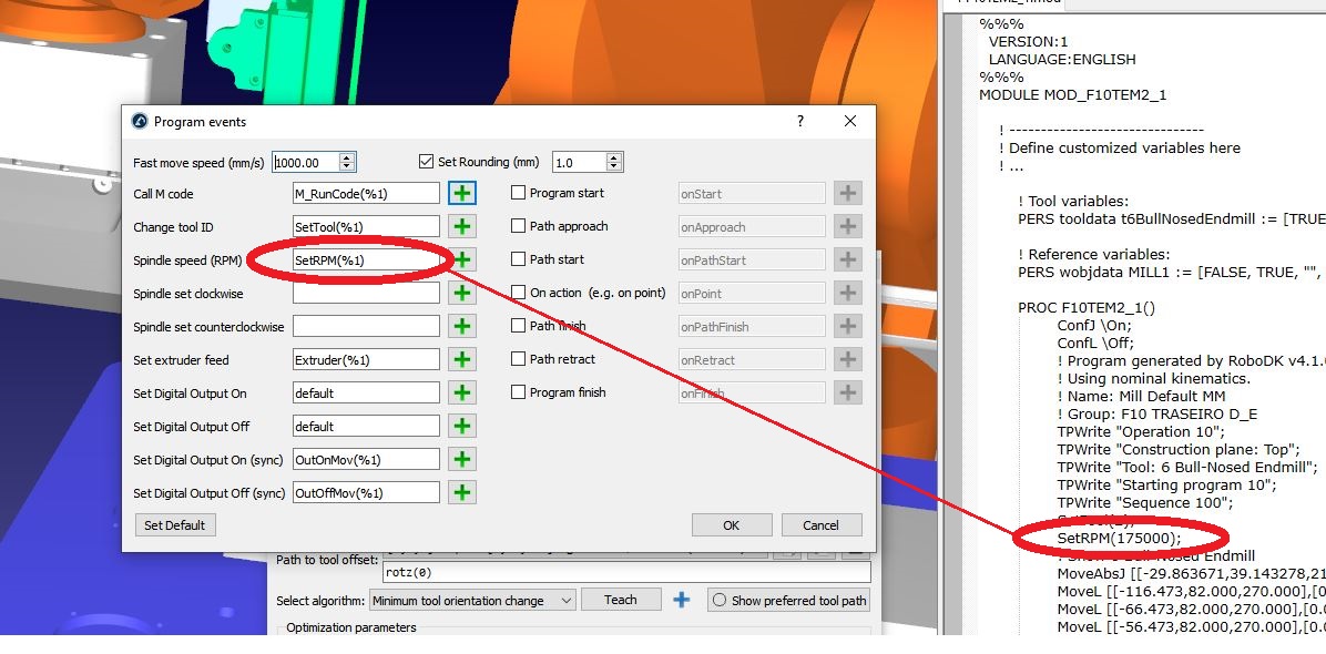

Hi Bruno,
I noticed the issue relies on the post processor removing the point character representing the decimal value.
You can do this as a quick workaround if you are using ABB:
  1. Select Program Events
  2. Select the + button on the Spindle speed event
  3. Select Insert code instead of Program call
  4. Provide this line:
    SetRPM %1;
We'll fix the post processor so it does not remove the decimal point.
