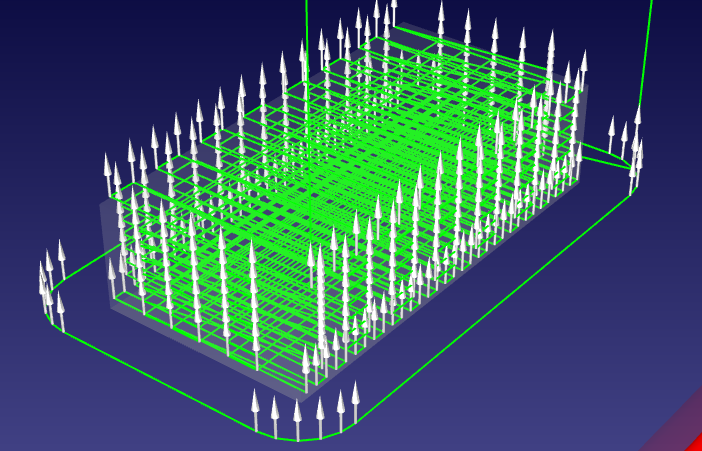

When we slice 3D model in robodk with slic3r, is it possible to choose the reference frame direction of the points making the path ?
For exemple, in attached file, is it possible to change the direction of the arrows ?

If you simply want to flip the arrow, the simplest solution would be the lot the arrow as-is and rotate your TCP 180 degrees around either its X or its Y.
You will also have to rotate the reference frame.
