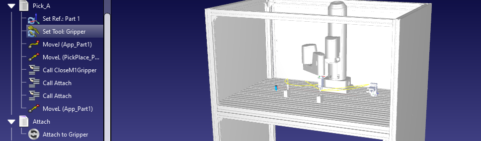

Hi, I would like to ask if anyone has this issue the situation is I would like to pick up a Test tube using a gripper from point A to point B. As I would be doing a Decap step at point B at such that at point A my Test Tube is being split into two parts the body and the cap. but however, when using the simulation event instruction I tried to select both objects but I want not able to simulate the gripping of both the Test tube body and cap.

It may be better if you attach the 2 parts of your tube in one object (the one you pick). Alternatively, you may need to create 2 events to attach both sides of the tube.
If you can share your RDK file we can better help you.

currently, I am using call "Attach" twice as such that I am able to pick up the cap and the body at the same time. I am unsure if that the correct way of doing.  attrach.png
