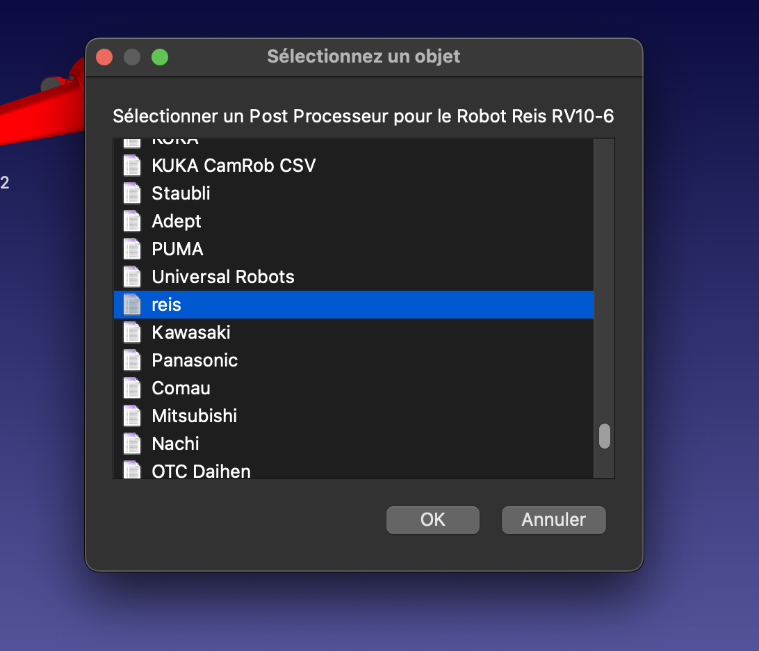

Hello again,
I saw a Reis post processor at the end of the list, with a different icon.
When I post process using it, it generates a .txt with the following message at the top.
// *** WARNING: Invalid license or undefined post processor to generate code for Reis RV10-6***
// *** The following program will not work on the Reis RV10-6 controller ***
// *** For more information:  https://robodk.com/  ***
The rests looks like standard code.
I attached the complete file below.
Do you have any idea ? Thanks.
.txt   REIS.txt (Size: 2.96 KB / Downloads: 258)
Our Robostar post processor generates JOB program files. You may need to change the post processor for your robot by right clicking on the robot, select Select Post Processor and then generate the program.
We may not have an official post processor that generates the files you need for your controller though.
