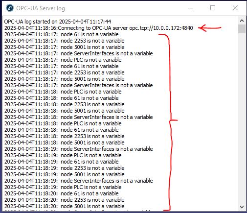

Hello, I'm trying to to connect RoboDK to an OPC UA Server. When I start RoboDK OPC UA Client it connects without any issues, I do get the message "Server variables retrieved", but no nodes are added in Station Parameters.
The OPC-UA Log shows "is not a variable" messages.

It seems like the RoboDK OPC UA Client is connecting to the OPC UA Server on the PLC, because in RoboDK OPC-UA Log, there in no error message regarding the connection, the log is showing that the nodes are not variables. Please see attached image.
Any other idea of what could be happening?
