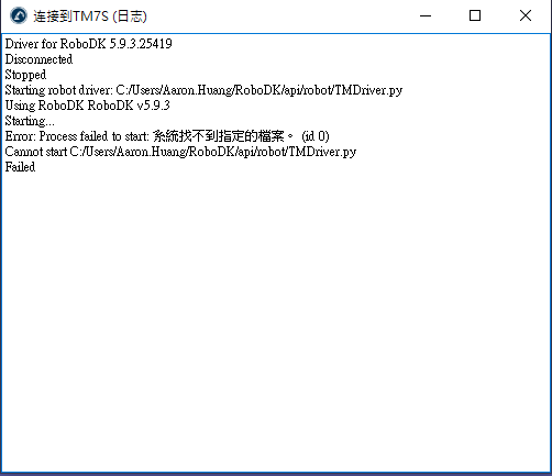

Hi Albert, I just downloaded the latest version (5.9.3), and it still had connection error. Cannot start D:/RoboDK/api/robot/TMDriver.py.
Or do I need to install it in the default drive - C drive?
Can you share more information that you see on driver log?

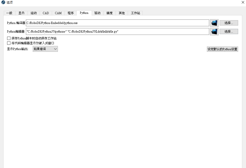

Are you using the default Python embedded interpreter in Tools-Options-Other?
Hi Albert, it just says "Error: Process failed to startConfusedystem cannot find the right file", cannot start TMDriver.py. then failed.
and i do not see any python option in tools-options-other, are you talking about tools-options-python?

It looks like you installed RoboDK in your user's application data folder.
Can you try updating the RoboDK interpreter accordingly? In this case, I assume your Python interpreter should be here:
C:/Users/username/RoboDK/Python-Embedded/python
