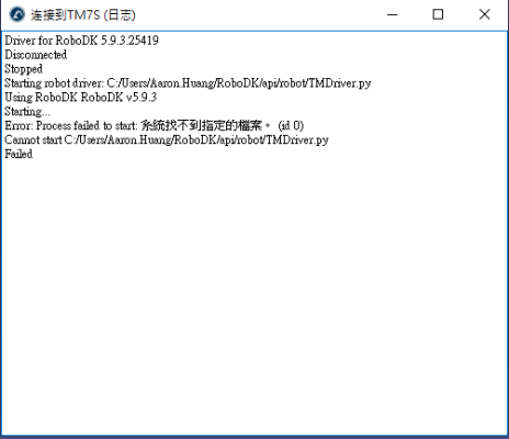

Hi Albert, it just says "Error: Process failed to startConfusedystem cannot find the right file", cannot start TMDriver.py. then failed.

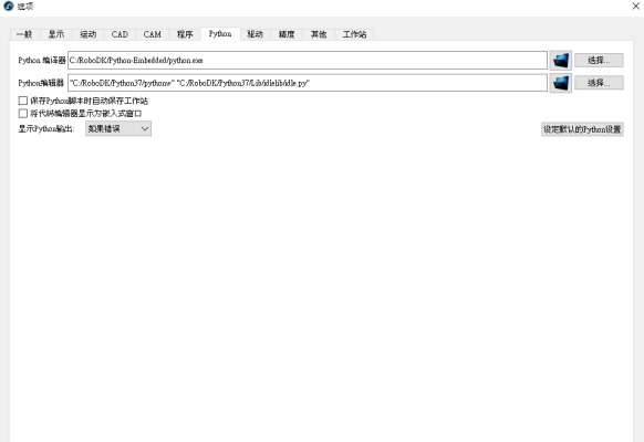

and i do not see any python option in tools-options-other, are you talking about tools-options-python?
It looks like you installed RoboDK in your user's application data folder.
Can you try updating the RoboDK interpreter accordingly? In this case, I assume your Python interpreter should be here:
C:/Users/username/RoboDK/Python-Embedded/python
