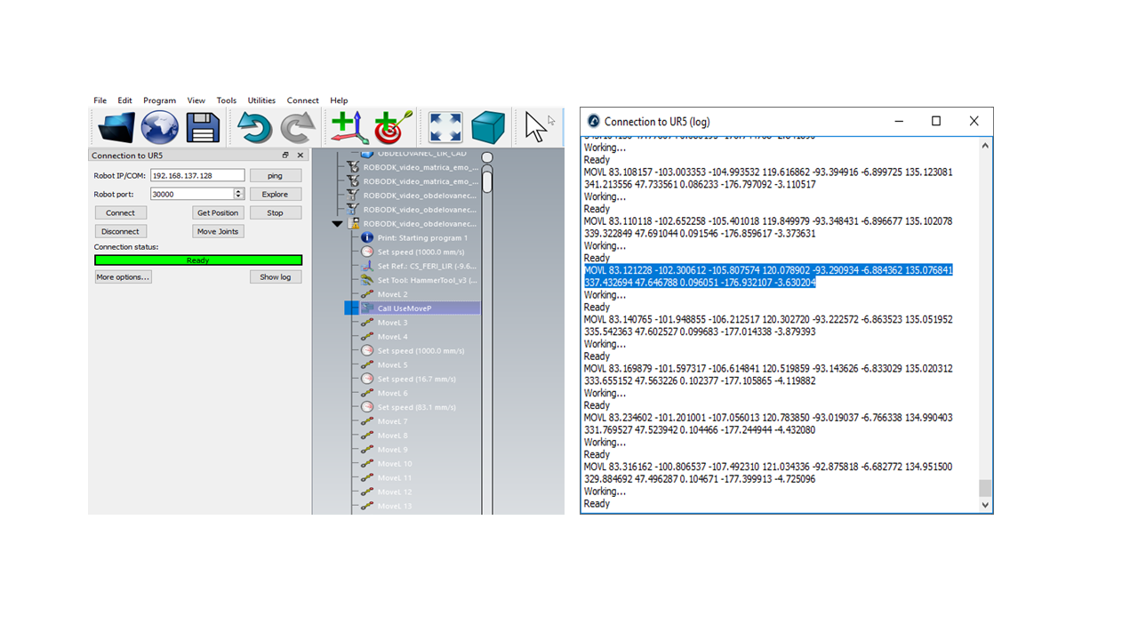

Hello!
If he uses  a call (UseMoveP) to switch linear moves to movep, I get this (picture in attachment).
I still have movel commands instead of movep.
Best regards.
Mitja
