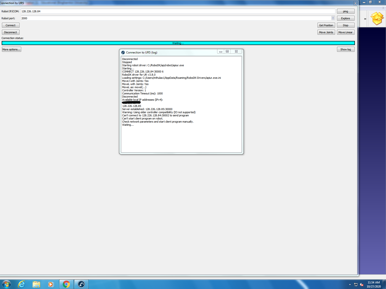

I'm not able to connect to UR5 robot using RoboDK software even after following all the steps in forums. I can ping the UR5 without issue, but the connection status bar never turns green, instead stopping at "Waiting...". I have attached a screenshot below, can someone help me with this process.`
UR5 : Universal Robots software : 3.3.0.145
RoboDK version: v3.8.1 -Educational(University)  Capture.PNG
I have turned off the firewall settings and done changes in .ini file, yet I'm not able to establish a connection.

Hi Midhun,
Updating to RoboDK version 5.1.1 would be a great first step.
Other than that, is your robot in "remote control" mode?
Hi Jeremy,
Thanks a lot for replying, I'll definitely update the software and I'm using CB3 series in which remote control mode is turned on as default setting. Is there anything else I need to do to make sure remote control mode is turned on?

Make sure that you have access to the robot port, that it's not blocked by any IT security.
Jeremy, I try these solutions and get back to you tomorrow. Thanks for your help. Thank you.
I have successfully connected UR5 to RoboDK by updating both. When I run the program I'm not able to control the gripper. Can you please let me know how to control the grippers.
