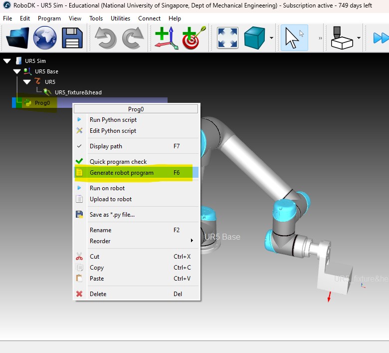

When I want to generate the robot code running in controller based on a imported python program. as shown in attached Fig 1.  RoboDK will crash. Note that my python prog can running sommthly by right clicking Run python Script in RoboDK software environment
After I adjusting my python program and regenerating robot code many times, I find that RoboDK will crash once involved points in my python file more than about four hundreds.
However, this crash has never happened before, even though my Python program involves more than a thousand points. It can geneate the robot code every time as long as I activate my license

(02-02-2024, 10:52 AM)Li Chenglin Wrote: When I want to generate the robot code running in controller based on a imported python program. as shown in attached Fig 1.  RoboDK will crash. Note that my python prog can running sommthly by right clicking Run python Script in RoboDK software environment

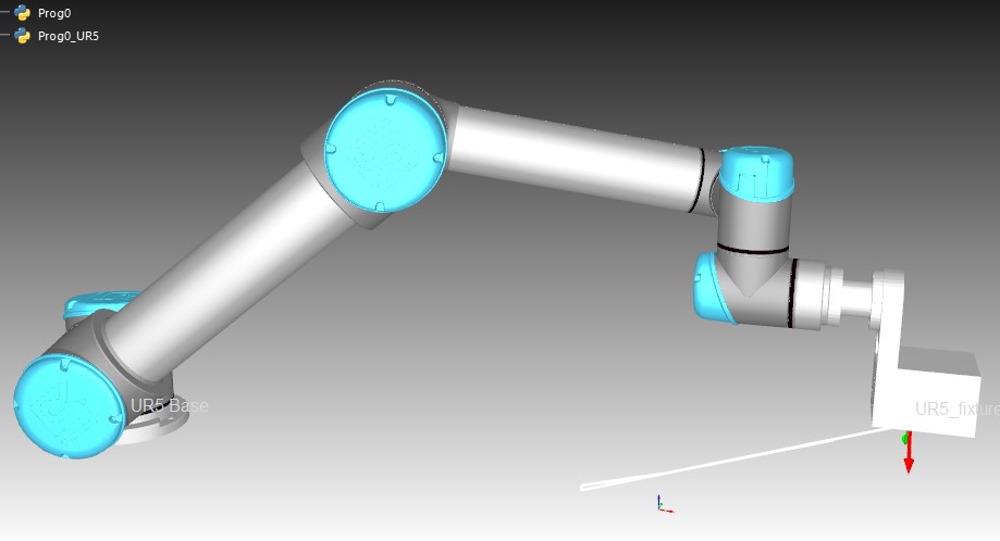

Besides, I also followed your advices to revise the Prog0_UR5.py. as shown in attached image. I also did a simulation to ensure that all points are reachable. The robot successfully completed the intended path as shown in attached II.
Unfortunately, When I use the generate robot code function, the roboDK will still be stuck for a moment and then crash.
Please help to solve these problems. Thank your very much!
