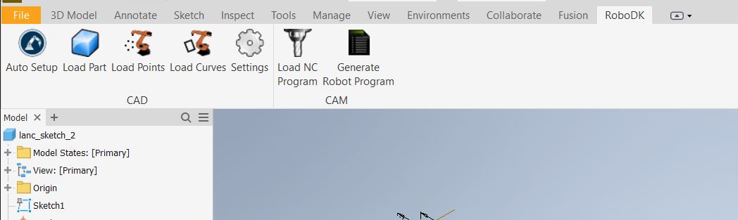

Inventor 2025
\Program Files\Autodesk\Inventor 2025\Bin\Addins\
Follow these steps to install RoboDK for Inventor 2025 or Inventor 2024:
  1. Unzip the BAT file attached in this folder: C:/RoboDK/Other/Plugin-Inventor/
  2. Run the file as an administrator.
Let us know if running this BAT script as an administrator does not work as expected.
