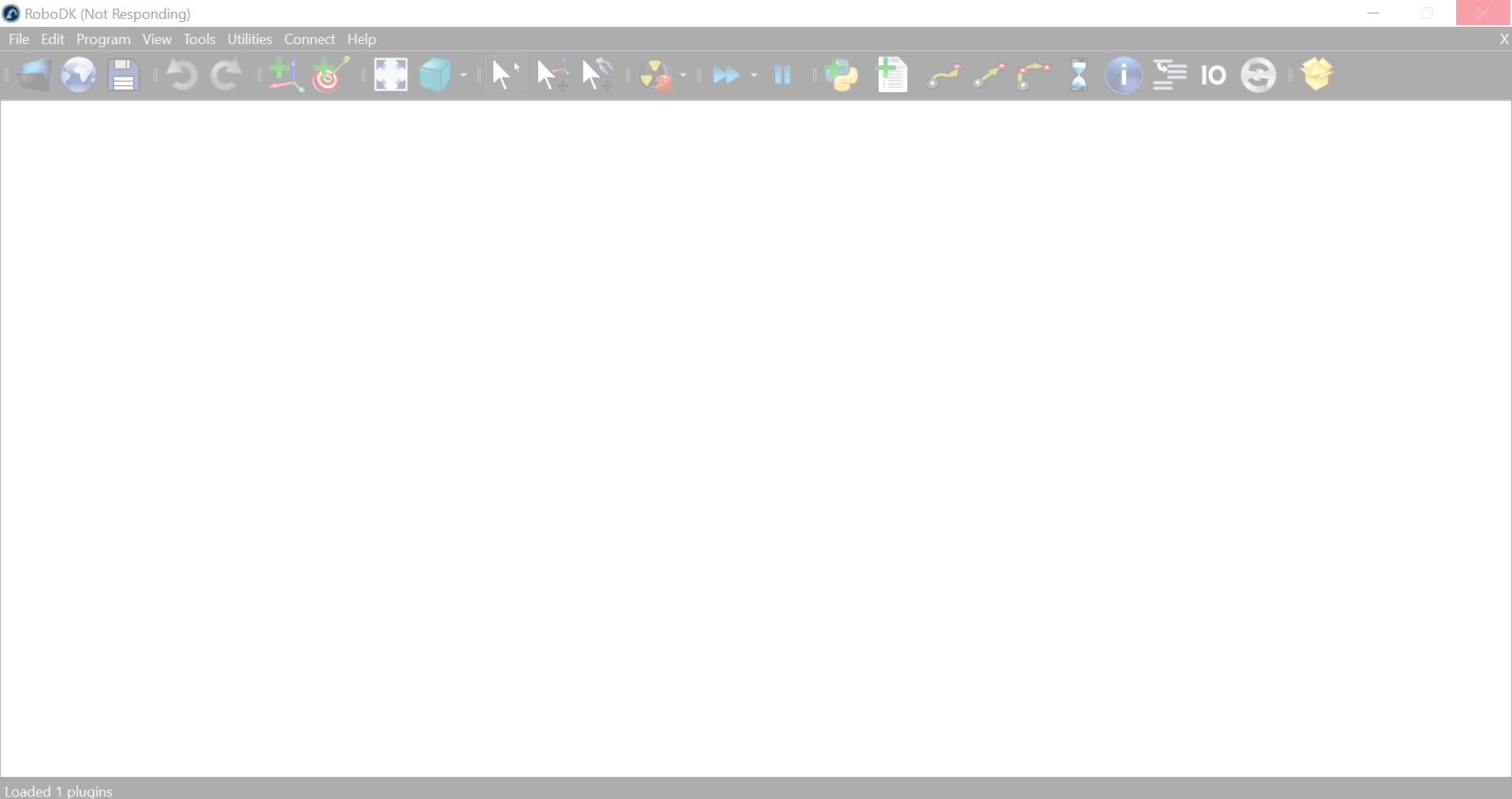

I installed the free trial version of RoboDK yesterday. Today it will not open at all. The gui begins to load but eventually does not respond. Will not work if I try to open my project from yesterday or open the program without any projects.
I tried to uninstall and reinstall the program but that had no effect either.
I also tried to run RoboDK-Debug.bat but again it would just open the gui and not respond.

This problem is related to your graphics card drivers. You should be able to start RoboDK safely by running this file:
C:/RoboDK/RoboDK-Safe-Start.bat
To fix the problem you see with the default build I recommend you to update your graphics card drivers. You may experience similar issues if you are using a virtual machine or a remote desktop connection.
Looks like that did the trick. Thanks!
