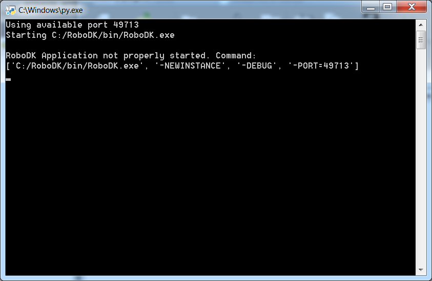

I've downloaded the lastest version from the homepage of Robodk sites.
This is a screen when i run the file "RoboDK-Debug-Live.py".
Thanks in advance,
Edoardo

Someone know how can solve the problem?
Thanks in advance
i solve the problem reinstalling the graphic card driver software with a version of opengp updated
