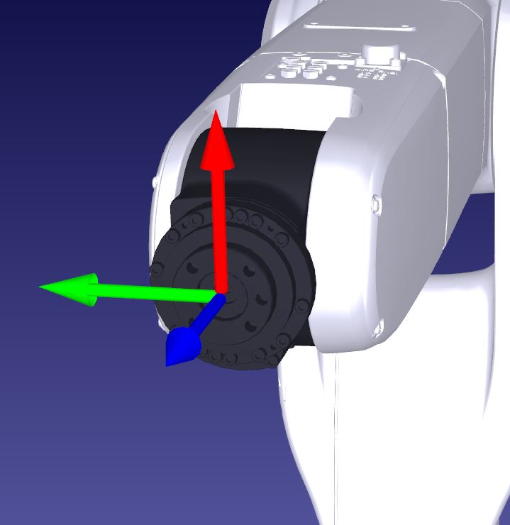

After Speaking with Denso the Euler angle is wrong.  The Y-axis is flipped. (green arrow should be pointing in the direction of the locating pinhole). Is there a way to change this? This would be the reason that my .RDk works fine when ran through RoboDk but move to Wincaps the TCP is flipped.
I have found this information but when I change the Euler angle type the direction on the flange does not change.

Thank you for your responses, according to John Manalac at Denso NA  the Robot Euler should be a rotational order is Rz, Ry, Rx.  The  Denso is currently set to Generic Rx, Ry, Rz. Hopefully, these photos are everything you are asking for.
As I also posted in a different post before I understood this problem, I commented how the exported RoboDk code needs to be altered so that the tool is oriented in the correct direction.
RoboDk TCP
Tool 2, P(-150.340,2.776,95.024,90.000,0.000,-90.000)
Denso Wincaps edited TCP
Tool 2, P(150.340,2.776,95.024,90.000,0.000,90.000)
Thanks in advance,
Austen
From what I can see, the flange reference is rotated 180 degrees.
I added an 180 degree rotation to the flange reference to match the version in Wincaps.
Also, the Euler angles can be changed to Epson/CRS to match the Euler rotation order of Rz, Ry, Rx.
Let me know if that fix the issue.

Hello @Olivier
I was able to find out how to rotate the tool in the advanced parameters before I saw this message. Thank you for responding and I'm glad that it was the same process.   It fixed all my TCP issues and I was able to calibrate and print properly.\
